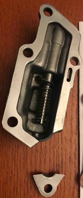

I had a slow leak from the Park Cable Cover on my 1965 A-904-G. I got it real smooth with some emery paper and as I tried to reinstall it I broke the ear off. I tried to JB weld it got it didn't hold. I'm going to try again with a thicker gasket and see if it holds. If it doesn't, Does anyone out there have one of these covers from an early (Pre '66) park cable cover?
I uploaded a picture but I don't know how to get it into the post.
File comment: Image of my broken Torquefilte Park Cover

PostPosted: Fri Mar 06, 2020 4:05 pm
Posts: 9093
I think I have an extra. Will check in the morning.
PostPosted: Fri Mar 06, 2020 4:30 pm
Posts: 1479
I likely have one as well, from my 65 Belvedere.

PostPosted: Sat Mar 07, 2020 7:23 am
Posts: 9093
Mike, are you wanting a trans for a V-8 or a Slant six?
PostPosted: Sat Mar 07, 2020 8:07 am
Posts: 9093
I have a spare park cable housing. I also have a "core" 1965 small block cable shifted trans.
FYI: A 65 trans is by itself. 64 and earlier can be used sort of interchangeably, but there are some minor changes you need to be aware of. 66 and up is completely different as far as swaping.

Thanks Charlie
I just need the cover for now. I have 2 slant 6 cars and 2 v8 cars. I am half looking for 65 "Cores" to keep around for parts or in case I get brave and try and rebuild one myself. I'd love to learn how. Just don't want to experiment on one of my working 904's.
Let me know what you want for the cover. Did you see the picture I included in the first post? That's what I"m looking for. The cover that the Park cable goes into.
Private message if you'd like.
Have you ever tried braising aluminum? I thought about trying to fix the broken one that I have. JB Weld didnt' hold.

PostPosted: Sat Mar 07, 2020 10:13 pm
Posts: 9093
If not able to find a good cover, I would go for TIG welding. I'll send you a PM.

Sorry to hear Charlie. You'll be missed at the races. We'll hope for the best for you wife.
There's a great welder here in my town. I may take it to him and see what he thinks. I also thought about stick brazing it myself. It doesn't have to hold any pressure just needs to be perfectly flat.

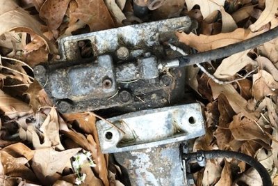

PostPosted: Mon Mar 23, 2020 3:35 pm
Posts: 1479
Hey Mike,
Did you ever find a replacement cover? If not, I have one off my 65 Belvedere A904 transmission. I have the cable (column shift) and really, the entire tailshaft. If you still need something, let me know.
-Matt

Thanks Charlie. Worked perfectly. You saved my neck. Those things are getting hard to find. I got it all together and the only thing left is the "O" ring around the cable has a very slow leak. I think it has always leaked some. Next time I take it a part I'll measure the O ring and see if I can get it to seal. I made a video of fixing it and posted it on youtube
