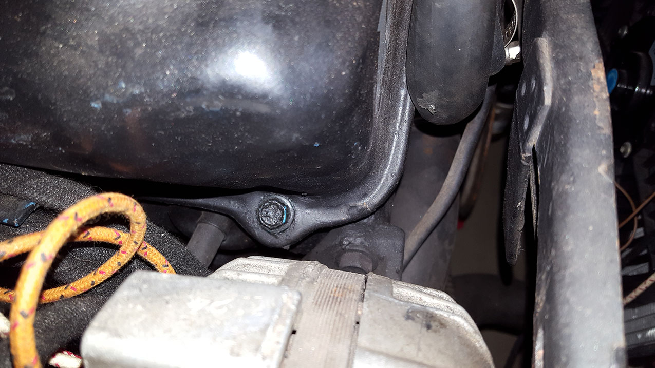

I couldn't get the valve cover off to look at the head casting numbers but it does have what looks like adjustable rockers. My phone takes too big of photos to add one. Could it just be a later valve cover?

Here is the front corner behind the alternator...
after reading this post http://www.slantsix.org/forum/viewtopic ... 3&start=15
I think it is a 60-80 head

Good deal, the close up is much better than the overall picture that is a bit misleading... that makes it easier, and 99.9% of being a
mechanical camshaft that can be reground....

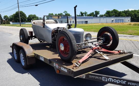

Here is another one. A lot of the engine mods will probably wait till winter. The plan now is to get some seats in it, fix some trans leaks, add some rear shocks and run the exhaust along the drivers side. Then drive it around and have fun
