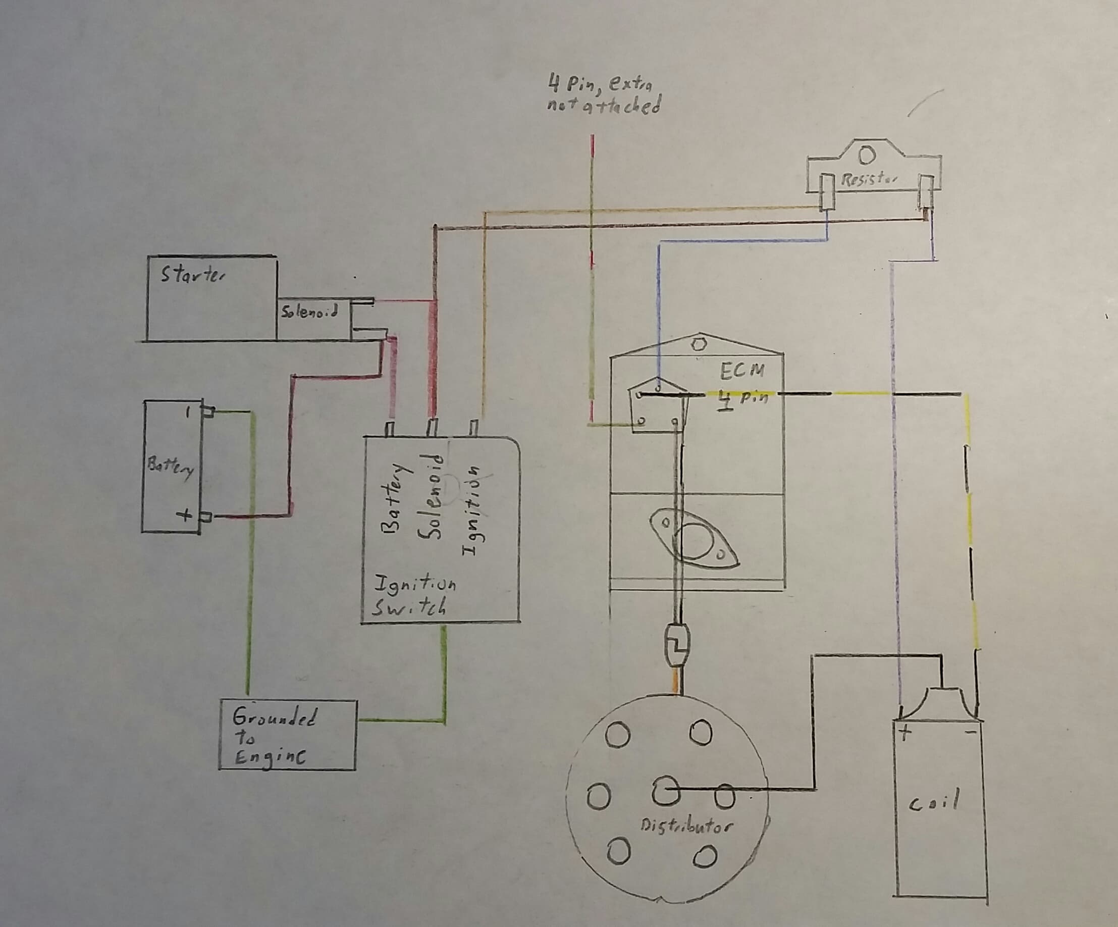

Hi all,
Below is my diagram. I hope it is clear enough to make sense of. Looking at everything as I drew this I wonder if I got the solenoid and ignition to resistor wires switched.
Sincerely,
Paul Barrow
 Post subject: Re: Engine not catching
PostPosted: Sun Apr 05, 2020 3:58 pm
You cannot have the starter solenoid connected to the ballast resistor. The solenoid will steal energy meant for the coil. Chrysler ignition switches have Ign 1, Ign 2 and start terminals because you need all of them. Delete the wire between the solenoid and the ballast resistor. A ballast resistor bypass will require more parts. A relay triggered by the solenoid wire being one method.
PostPosted: Sun Apr 05, 2020 6:30 pm
Posts: 3136
that solenoid to ballast wire is just the full 12v "kick"/ "ballast bypass during start" I wouldn't think the ignition would bleed that much, from the starter solenoid's function.....
PostPosted: Mon Apr 06, 2020 6:26 am
Posts: 156
Car Model: 1962 Dodge Dart
Thanks guys,
I suppose one question to ask would be is there any way I could wire this incorrectly that would cause damage? If not, I will try your suggestion tonight Joshie.
Thanks again,
Paul
PostPosted: Mon Apr 06, 2020 9:53 am
Posts: 831
Location: Tompkinsville, KY
Since it seems to want to fire while cranking, I wouldn't think the start circuit is the problem.
You say that it dies when the key is released to the run position so I would look at that part of the circuit, especially the ballast itself.
What is the voltage at the coil with the key in the run position?
You might try bypassing the ballast temporarily as an experiment.
By the way, nice job on the schematic 8)
PostPosted: Mon Apr 06, 2020 10:13 am
If he bypasses the ballast resistor without making other changes to his wiring the starter will engage when the ignition switch is on. The interconnection between the starter solenoid and the ignition must be removed.
PostPosted: Mon Apr 06, 2020 10:17 am
Posts: 831
True - hence your point about properly wiring the bypass.
A temporary 'run' bypass is usually considered 'hot-wiring', such as a wire straight from B+ to the coil.
I'm sorry for not more clearly making the connection :lol: :wink:
O==\=/==O
"A mechanic is Somebody."
- Jim Preston
PostPosted: Mon Apr 06, 2020 10:32 am
Posts: 3136
Yeah didn't think about that.
I'm thinking of the old 4 pin ballast and 5 pin ecu,not the 2 pin ballast and 4pin ecu. I was thinking if he went off of the same terminal from the starter relay that the small wire on the starter solenoid is wired from that it would be a safe way to go but maybe not
