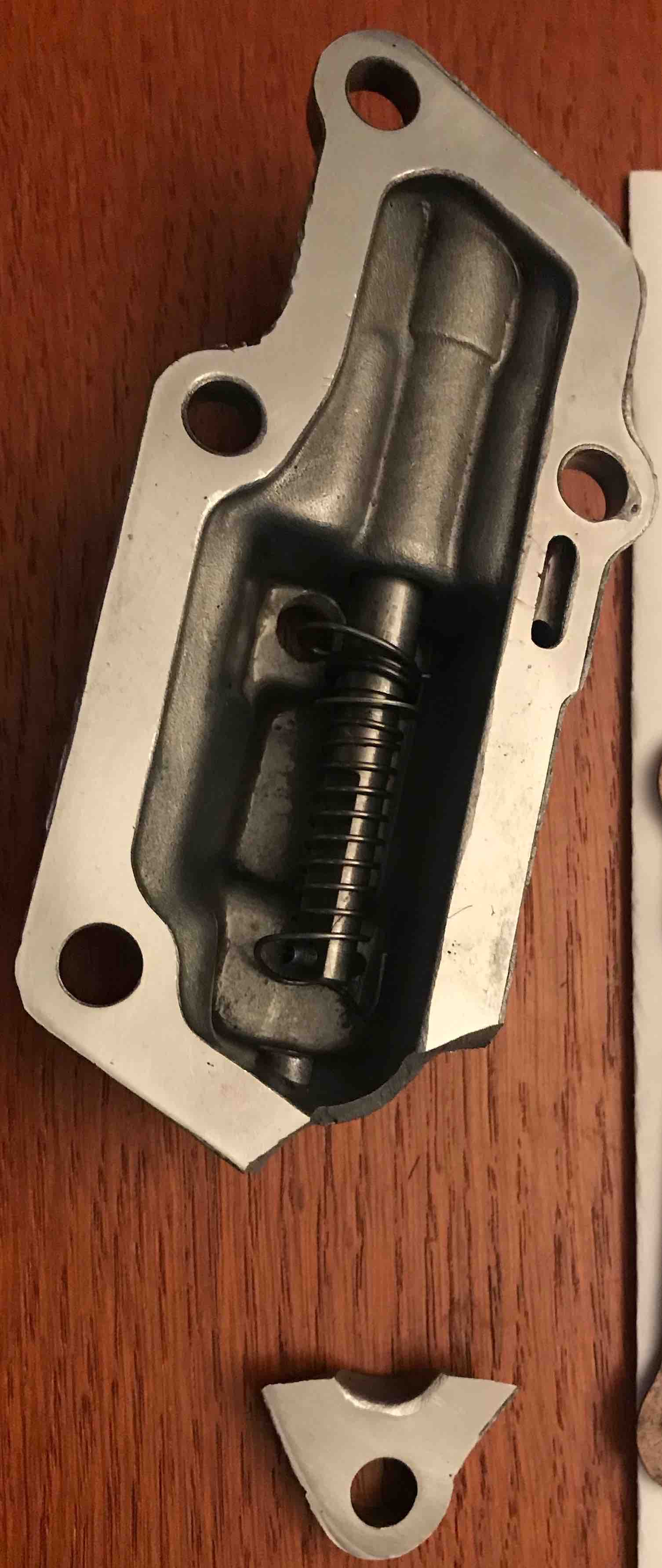

I had a slow leak from the Park Cable Cover on my 1965 A-904-G. I got it real smooth with some emery paper and as I tried to reinstall it I broke the ear off. I tried to JB weld it got it didn't hold. I'm going to try again with a thicker gasket and see if it holds. If it doesn't, Does anyone out there have one of these covers from an early (Pre '66) park cable cover?
I uploaded a picture but I don't know how to get it into the post.
File comment: Image of my broken Torquefilte Park Cover

PostPosted: Fri Mar 06, 2020 4:05 pm
Posts: 9092
I think I have an extra. Will check in the morning.
PostPosted: Fri Mar 06, 2020 4:30 pm
Posts: 1479
I likely have one as well, from my 65 Belvedere.

Let me know what you want for the cover. Did you see the picture I included in the first post? That's what I"m looking for. The cover that the Park cable goes into.

Have you ever tried braising aluminum? I thought about trying to fix the broken one that I have. JB Weld didnt' hold.

If not able to find a good cover, I would go for TIG welding. I'll send you a PM.

There's a great welder here in my town. I may take it to him and see what he thinks. I also thought about stick brazing it myself. It doesn't have to hold any pressure just needs to be perfectly flat.

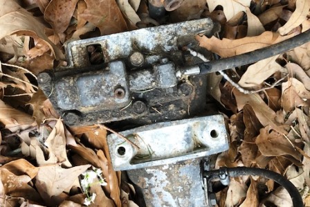

Thanks Charlie. Worked perfectly. You saved my neck. Those things are getting hard to find. I got it all together and the only thing left is the "O" ring around the cable has a very slow leak. I think it has always leaked some. Next time I take it a part I'll measure the O ring and see if I can get it to seal. I made a video of fixing it and posted it on youtube
