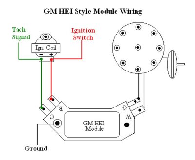

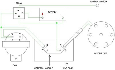

Attached are two of the most basic HEI diagrams. One with a relay, one without.
Either way, the "Ignition Switch" signal is the "Start/Run" from the OE vehicle wiring.

FYI, Your wiring diagram looks like it is correct. Maybe you should check to see if you have any wires accidently grounded, especially to the coil.
