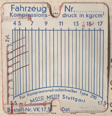

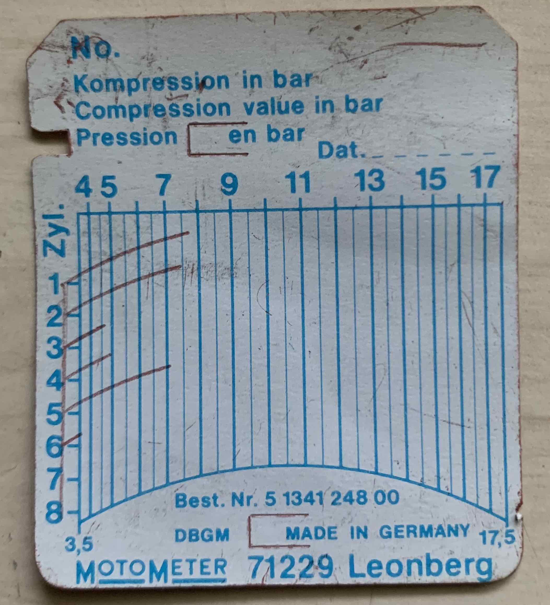

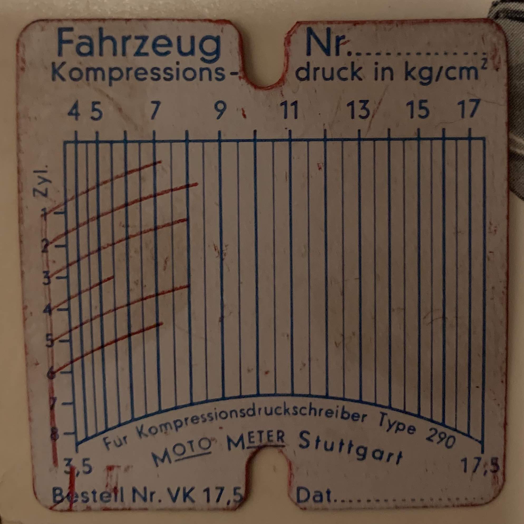

Here's a little update about my motor.
The compression test after checking the valve lash was not that satisfying, so i had no other choice than remove the cylinder head.
I saw, that not a long time ago, someone else replaced the head gasket and the valves . But the valve seats didn't look that great. If I had replaced the valves by myself, i would have replaced the seats too.
So i did my best and grinded the valves and seats with professional tools.
You can see in the picture down below what came out: First measuring, after setting the valve lash, and after my work with the valves.
In near future I will replace the valve seats. If you have any recommendations where to buy the parts (Valves, seats, stem seals etc.) which can be shipped to Europe, I would be thankful for that.
Have a nice weekend!
