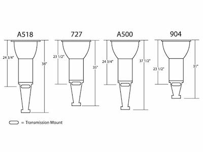

I would think that if the 904 was out of a car. The transmission mount location might be different as well.

That's a good point, Greg. I thought of that too and did some looking around and found this (on FABO, I think):
I hadn't considered a car and pickup dimensions possibly being different.
I just went out to the garage and measured the 904. It is 22-3/4" to the center of the trans mount bolt holes which are kinda positioned towards the front of the mounting pad. The 23-1/2" appears to be near the middle of the pad. I'll get a close look at the 727 tomorrow.

when I have swapped between 904/727, the mount point was always the same. car or truck. the main difference is tailshaft length and output shaft spline count/diameter between the 2 series of trans

It seems according to the chart you have there, the OD trans's Have the mount moved, but the 727 / 904 share the same location... I must be just thinking of the tail shaft length.... not the mount point.

I set myself an alarm to measure that 727 trans this afternoon. I probably would have forgot otherwise. :roll:
Anyway, the 727 measures the same dimension as the 904.
