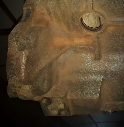

PostPosted: Wed Jan 27, 2021 4:50 pm
I don't know what you mean by the web behind the water pump.
This detail is described in the article Slant Six Blocks by Doc.
https://www.slantsix.org/articles/dutra ... blocks.htm
I don't think that's accurate. Here's a picture of my cast crank block and the water pump pocket reinforcement is of the same tapered style as the forged crank engine Doc pictured. Sorry about the picture quality, but I'm still cleaning the block.
PostPosted: Wed Jan 27, 2021 6:02 pm
Posts: 399
Location: Pauls Valley, OK
Car Model: 1975 Dodge D100
After reading that same description I used to wonder about that too. It helped me to think up and down thickness instead of side to side width.
The web on a forged crank block gets thicker and wider on the block end. The same web on a cast crank block gets wider but stays the same thickness.
PostPosted: Wed Jan 27, 2021 7:20 pm
Sure. I still think the casting number is easier to see.
PostPosted: Thu Jan 28, 2021 4:35 am
:oops: :oops:
Well then.... I s'pose I prolly do have a few then.... :roll:
All these years I read that article to mean the thickness of the "gusset" as actually the width. Now that it's been pointed out I can see the more subtle increase in thickness of the rib...
