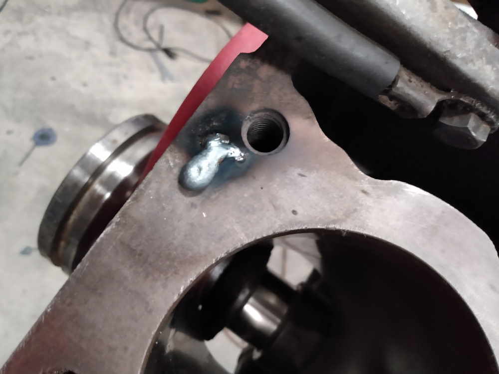

Thanks. Tried to weld it...
File comment: Oops.
Unfortunately, my welding skills weren't up to the job. Time for the drill.

looks like you forgot the nut..... welded right on the block deck....
I didn't forget the nut - I liquefied it! The blob actually turned out not to be stuck to the deck.
