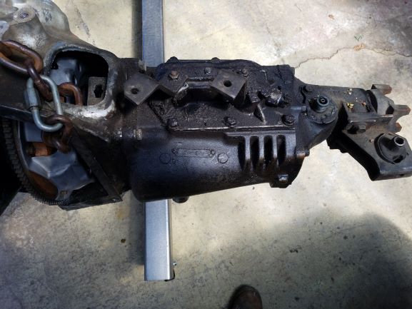

I recently acquired an low mileage '72 slant with this manual transmission/new clutch/surfaced flywheel attached. I have no use for it whatsoever, but maybe somebody does. I'd like to identify it, and request some advice on a fair asking price for all three components as a package. I've got some questions about the engine as well, so I'll post those in the appropriate forum section--just to break tradition with most forums on the net. Based on the condition of the engine, I'd be willing to guarantee this transmission was never abused, and probably received proper maintenance. I believe I heard him say it was a 3 speed, but I'm not certain of that since I was primarily focused on the engine.

That angle makes the levers and side a bit odd.. Maybe share a picture of the Top, Yoke area - is it a slip yoke or a fixed yoke.
It's a 3 speed, but I am not sure what model / Production code it would be.. I have never seen one short and with the ribs on the bottom of the case.

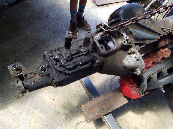

Yeah, I did a fair good bit of looking around on the web, before deciding to ask for help. And I didn't find anything that really looked exactly like it. Here's another pic. I'll look for some numbers on the trans next time I'm at its location.

I don't know the model designation, but it looks like a 3 speed all syncro columm shift. For a 4 wheeldrive truck. Has a rear sump oil pan on the engine, and it looks like the yoke on the trans is bolted on, for a drive shaft to a transfer case.
PostPosted: Fri May 28, 2021 3:33 pm
My 1974 D100 had the same transmission. It's a fixed yoke transmission used with a two-piece driveshaft. Or possibly a divorced transfer case four-wheel drive, but those disappeared by the 1970s. If someone needs one it's probably worth $200, maybe more, but the demand is going to be very low. The standard 3-speed in 1972 was the A250 unless you had a crew cab and then it was the A230.

That all makes sense. It came out of an early 70's truck. The 20 something year old owner inherited it from his dad, who was a former fleet mechanic in the Prineville area, really nice guy. Told me everything I'd want to know about the engine, which is remarkably clean inside and out (I pulled the pan to install some rod bearings, ARP bolts, and check the mains). Anyway, the kid pulled the slant as soon as he got it, and dropped in a mildly built 360. He was at least willing to admit his mistake. Said he wished he'd kept the slant, since his fuel use had nearly doubled, and truck ran like crap unless his foot was in it. Oh to be young and foolish again.
