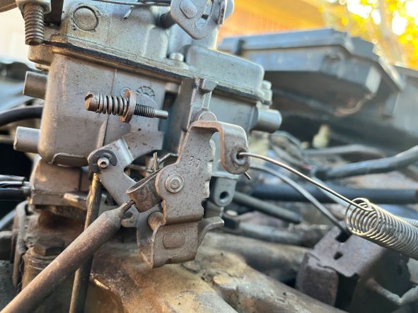

Here is the back of the carb

Thanks for all the help, matv. After rigging up a spring and adjusting the linkage, it’s shifting perfectly now. Now all I need is a proper carb and I’ll be set!
