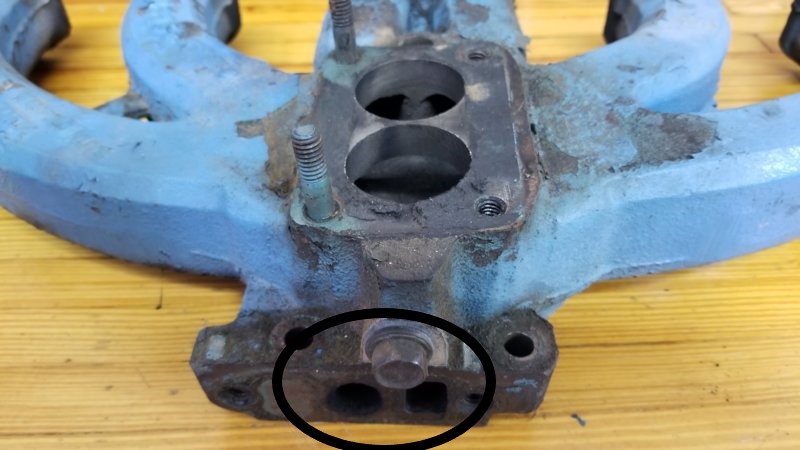

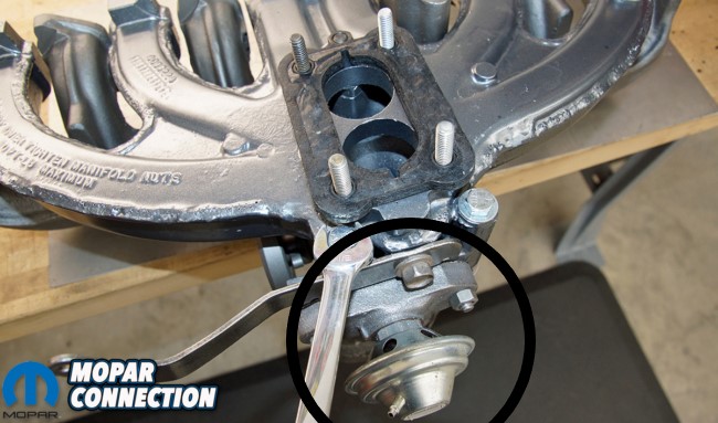

On the slant, the EGR valve is just below the carb mount on the driver side of the intake. If nothing is there, you will need a block off plate to prevent a vacuum leak.
Here with the EGR valve bolted on.
Here with it removed.

Thanks, Matt. Will check it out tomorrow morning. I have used that intake for a long time, but maybe things have just deteriorated.

Filled those holes w/ the orange RTV and blocked off with a flat piece of metal in addition to the piece that was already there.
Then I bought one of those EGR block-offs that they sell on Ebay and used the gasket that came with the intake/exhaust manifold and bolted that up. Not sure what I am blocking with that one, though.
Now it's cold and I can't get it running, still.
