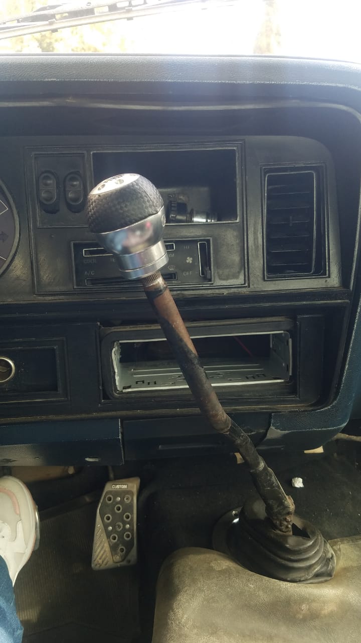

Some pictures of the transmission or shifter / hump area would be helpful.

Does this picture help
PostPosted: Fri Jan 21, 2022 8:58 am
Posts: 9535
Yes, that is the non overdrive transmission.

So it's a NP435?
PostPosted: Fri Jan 21, 2022 9:40 am
Posts: 10443
So it's a NP435?
I have that trans in my '77 D200..
4.10 Rear Gear Ratio with 235 85 16 Tires
It will do 100Mph or more..
The engine is quite wound up but it will do it.
