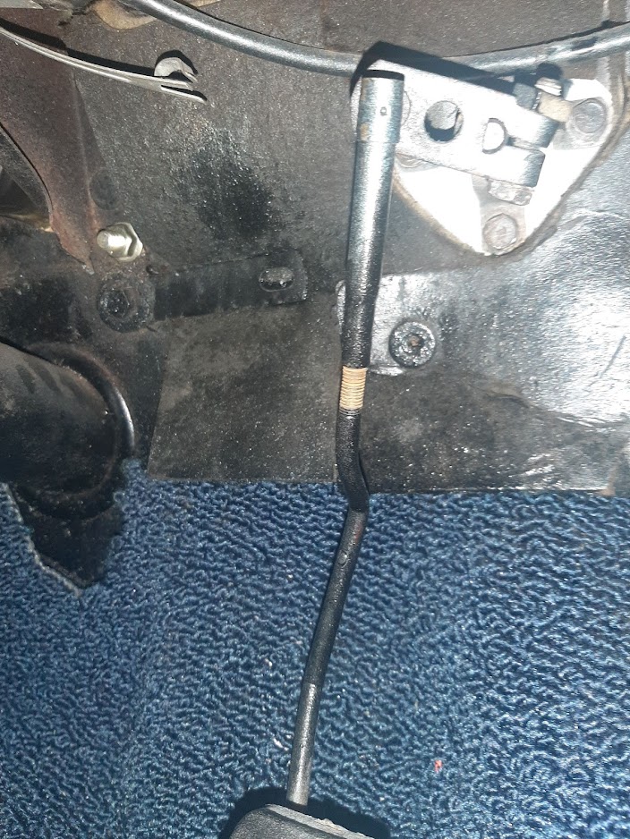

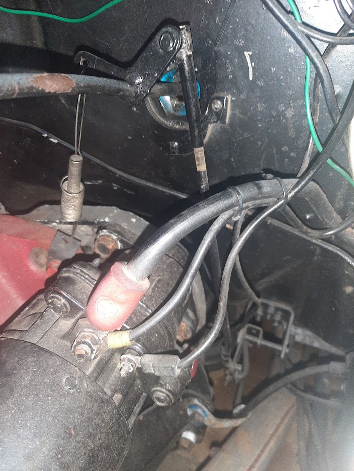

It was 100% the linkage WAY out of adjustment to fit the (wrong) 1982 carb. I had to extend both the pedal rod and the kickdown rod. It works great now.

I had to make some pretty big adjustments on my throttle pedal and kick down linkage when swapping carbs. The P.O. had the wrong carb hooked up and had it all out of whack. You can see the newly exposed threads in the pics.
