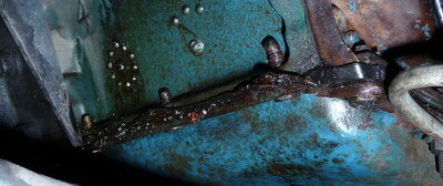

The lower rail pan gasket is bulging out at both ends and along its run in one place. Here’s a view of the front end, before i started messing with anything:
oil pan gasket, passenger side view close SL6com edit.jpg [ 68.52 KiB | Viewed 4879 times ]

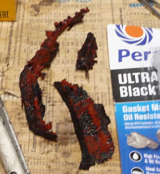

So yesterday i did the dance of getting new oil + filter, fresh new 95g tube of Permatex 82180 Ultra Black, etc. for the job. Drained out the oil + removed the filter as usual with the engine nice and warm. Gave it hours to drain, then went back to start cleaning out the gap, knowing from the wisdom here and many other places that RTV isn’t going to adhere well (or at all) to oily surfaces.
Here’s where i may have really screwed up. It’s always looked to me like there was nothing other than RTV in that gap, which would not even slightly surprise me given what the previous owner did or allowed to be done and the decades i’ve spent undoing the corner-cutting. So i dug and i dug and for awhile all seemed good until i pulled out a big piece and looked carefully: cork (or similar) gasket, that i just wholesale tore off. Here’s what i dug out before i stopped (Ultra Black package corner shown for scale; apologies for the poor focus):
I stopped digging but kept solvent cleaning, using cotton swabs to get as deep into the gaps as possible, all the way along that lower rail and as much as i could near the corners with the end rubber gaskets in place. Took a long time and a lot of swabs, but eventually it was as clean as humanly possible. Getting dark, so gave it overnight for every trace of solvent to evaporate.

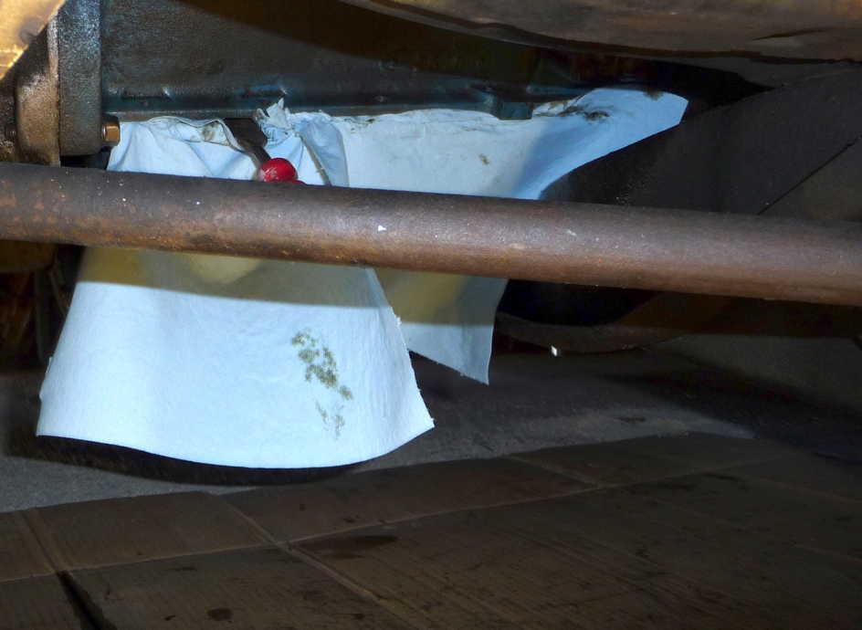

This morning i came out to set up to apply the Ultra Black, and to my great dismay found a line of oil pretty much all the way along that edge. How long does it take for these engines to finish draining down, so that edge will stay clean? Wiped down the edge again with a shop towel (one of those blue paper tear-off roll kind), then mostly as an exercise in futility, i used a shop vac crevice nozzle to suck out what i could, which seemed to do very little. Unsure how to proceed, i stuffed clean blue paper shop towel edges as far in as i could along the whole length (other than where the old chisel is holding the gap open). Very little to show for it after half an hour:
It’s now several hours later and i just went and looked again, and it looks exactly as in the photo. Would have thought that the towels would wick out whatever oil is still draining down and passing by and/or sitting there inside.
How does a mere mortal get that edge to stay clean and dry long enough to properly apply something like Ultra Black and have it cure and adhere properly?

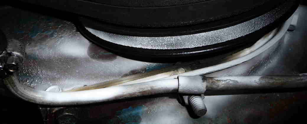

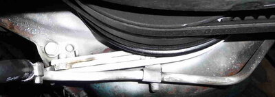

Thank you for this suggestion. I’m getting what to me are ambiguous results. Here’s what i did:
1) Cleaned area with engine degreaser & water, mostly per product’s instructions other than allowing to air dry for several hours rather than running engine to dry, since running the engine could trigger the leak and spraying the powder on wet was unlikely to be helpful.
2) Sprayed on the powder. Here’s a Before picture:
3) Ran the engine for about 15 min. Here are the After pics:
Is this a combo leak of the front gasket AND somewhere up higher? Not sure how to interpret what i’m seeing, thus unsure how to proceed.

PostPosted: Thu Jun 09, 2022 3:27 pm
Posts: 798
Location: Rio Rancho, NM
...Is this a combo leak of the front gasket AND somewhere up higher? Not sure how to interpret what i’m seeing, thus unsure how to proceed.
It looks like the front crank seal is leaking. Also looks like the joint between the timing cover and oil pan but if you replace the crank seal you will have the timing cover off and will need to replace the related gaskets to put it back together.
If I was going to dive into this job I'd also replace the timing chain, gears and water pump. Unless those things have low mileage.
