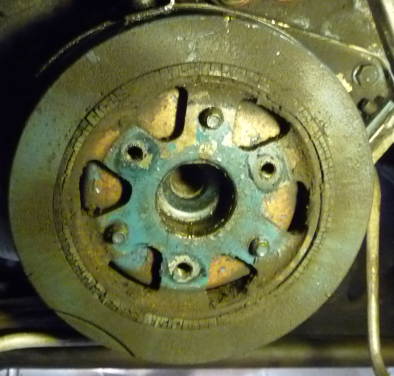

Jan. 2009, (1)26195 miles: verified vibration damper timing mark with degree wheel and piston stop: exactly correct. Currently (1)34361 miles—8166 miles driven since verification—and front of vibration damper looks like this:
A couple of professional shops plus biennial emissions inspection stations have since then needed to verify timing, never finding/reporting to me any issues with instability nor improper timing marks.
Thoughts on whether this existing damper is OK? Do i need one (another one or this one rebuilt) from Damper Dudes? It’s the 2 pulley groove style.

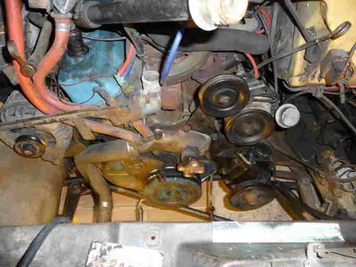

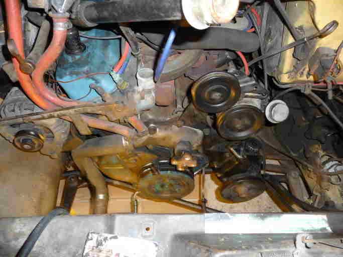

Workflow from current stage of disassembly, pictured:

Damper: I would use that one, based on basic visual inspection. The later ones rarely slip. Get a TDC piston stop tool (or make one) and make sure it is marked correctly and has not slipped.

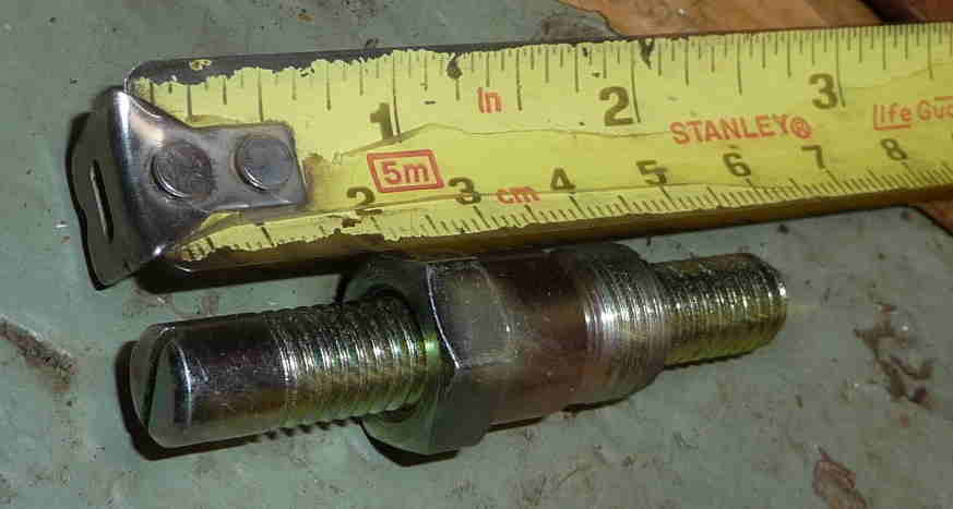

Any reason this piston stop i have is lacking?:
Worked great in 2009.

That piston stop is fine.

Excellent!
What i’m seeing in the pics for the hydraulic lifter pushrod is that even though it has a ball on top, there is an oil hole. Wouldn’t the tip of the dial indicator be stable on/in that? Or maybe i could temporarily put something in the oil hole, like a very small piece of cup-shaped plastic?
I’ve never looked at the actual ends of the existing lifters, nor have i yet used nor even held in my hand a dial indicator, so these assumptions i’m making may be misguided. Hence i seek confirmation.
Also, i gather that the one rocker needs to come off? Maybe that means the whole rocker arm assembly? I’d hoped that maybe i could put the dial indicator on top of the rocker arm on the side where the pushrod pushes, and that might be good enough (and would require that much less assembly). Or is it then an issue of all the pressure of the rocker arm and valve pushing against the hydraulic lifter?
Thanks!
