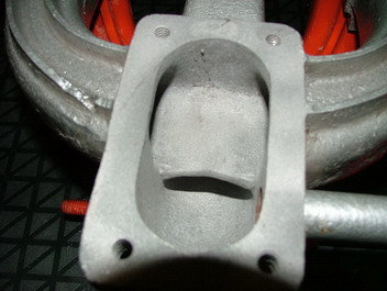

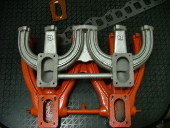

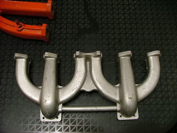

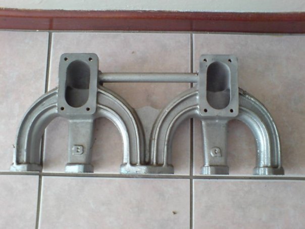

Cool project, nice-looking result, but using RTV inside the intake like this makes my beard stand on end. Yes, RTV is gasoline-resistant to a degree, but that's for incidental exposure, not a constant steady high-velocity gasoline shower. I really think you should clean that RTV all the way out of there and either leave it (and any substitute) out, or use a more suitable material—preferably one that involves welding equipment, not a squeeze-tube. The consequences of sucking glue of whatever kind into the engine can be worse than they might seem; RTV is made out of silicone. When silicone is burned, you get silica, a high abrasive that can do a real job on things like cylinders.
I might also quibble a little with calling this a "dual plane" intake. It's a divided single-plane intake. Here's a dual-plane, dual-carb Slant-6 intake:

OK, I will tear it down and remove the silicone. Lacking a mig or tig welder, I will have to break down and try Durafix aluminum brazing rods to secure the divider.
As far as "dual plane" goes, that South African manifold looks pretty nifty, but it seems like an over complicated way of achieving the same effect as I did. I think balancing the micture in that dual carb intake with the stacked plenums would be a nightmare. It seems to e that splitting a stock arrangement manifold down the middle and running a transverse mounted carb achieves the same goal of a separate intake plenum for each half of the engine, but since it is an in-line engine as opposed to a V shaped engine, the plenums do not need to stack. Then again, I am by no means an expert on this stuff and could be missing some advantage to the stacked runners on that South African intake.
