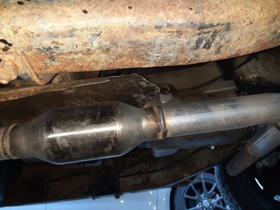

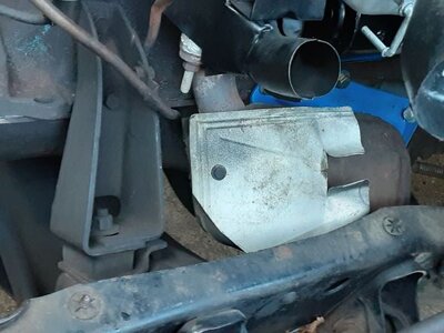

Hello all,
I have an 86 d100 with a slant six/4 speed. The leanburn is gone and mopar electronic ignition has been installed in its place. I received the truck with just one cat on it and straight pipped (was a joy on the high way lol). All the emission stuff was deleted off (by the previous owner) so i been trying to unfubar the thing somewhat. I did go ahead and install new 2 1/4" pipe attached to the down pipe with a new high flow secondary cat (believe its a 3 way). My question is can i just have the one high flow cat without the smog pump hooked up or would it be beneficial to plumb in a new air injection line into a new down pipe minus the first cat. or when i go to fab up a new down pipe should i weld in another cat and plumb a new A.I.R line to that or just leave the smog pump/line off all together. I had my fill of exhaust fabrication for a bit lol so id rather not melt/toast the cat(s) anytime soon. Also if i should go the route of the smog pump should the diverter valve be hooked up to manifold vacuum or ported vacuum (the pipe going to the cylinder head wont be installed).

My 85 came with most of the same setup on it, but was otherwise badly butchered/cobbled. I totally redid the under hood wiring harness and did the lean burn delete the right way rather than the butchery done before I got it, (the lean burn was still there but only one of the pickups in the distributor was crudely connected, I have talked about how much of a fire hazard this truck was in older posts here, won't rehash it all here) and the rear cat was completely plugged with remnants of what used to be the front cat "brick", it runs great now but I'll just say that it can't ever have a cat go bad again with how it's currently set up....

You definitely want to keep the air pump if you're running a catalytic converter. And don't get sucker(punch)ed by so-called "high-flow" catalytic converters; most of them are a waste of money, time, and effort. A good catalytic converter—for definitions of "good" that apply to carbureted vehicles—will cost more but last much longer and be much more resistant to internal meltdown; see here.
Rest of the exhaust system (pipes, muffler) see here.
Do you have a pic with how you have it set up by chance

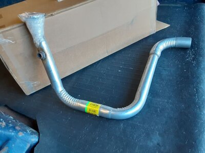

(update after much deliberating/attempt at part hunting) if anyone is looking for the down pipe without the cat. for the slant six on d100/d150 Waldron can custom order you one for a decent price (165 plus the ride). I believe its similar to the old walker exhaust 44958 that is no longer made. Looks like it should fit my 86 pretty nicely.

Waldron? Huh?
What's the pipe size(diameter) of that one? I made one from scraps for mine a while ago, started with an original stub I got with a super 6 manifold stack and raided a scrap dumpster at a local exhaust shop, had some stainless (whatever grade OE exhaust is on newer vehicles) 2-1/4 pipe in there that was taken off of who knows what, looked like it wasn't far from brand new, I cut all the elbows out of it (kinda like a summit or jegs DIY header kit) and eyeballed it on my truck and mig'd it all together. I did a decent job welding and positioning what I had but being it's 4-5 short sections welded together from manifold to muffler inlet, but it looks the part (cobbled)
