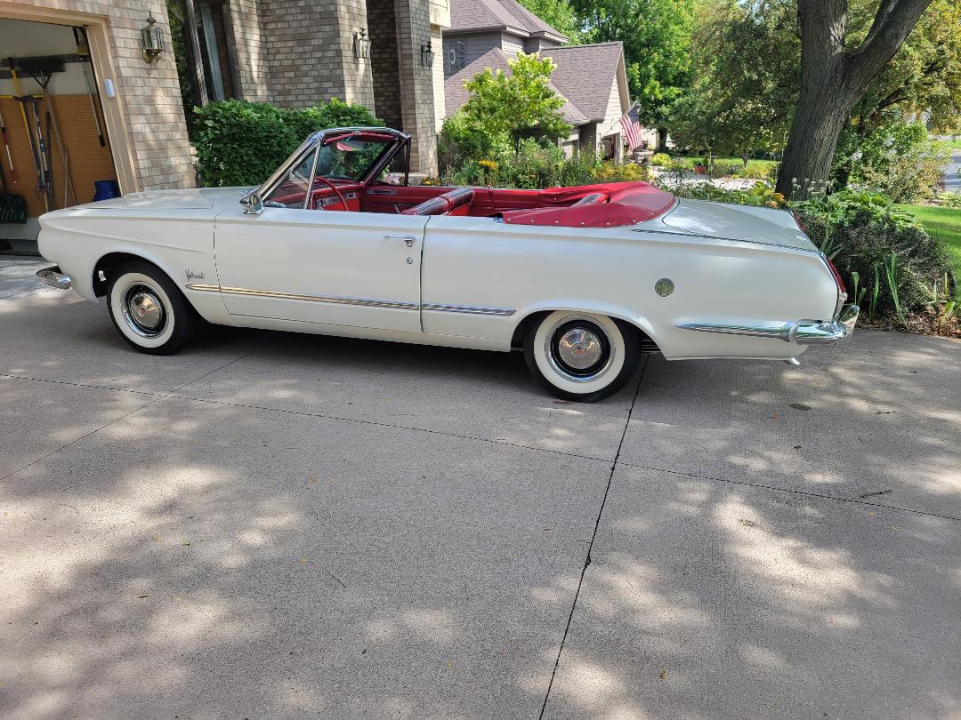

Appreciate the experienced advice. I have returned the transmission pan and purchased the mopar oil pan - 52118779AD.
I have restored a 64 Valiant and had my shares of issues and don't want any additional uneeded down the road.
The car was my father in laws and had family sentimental value. A few little issues still here and there but now can mostly enjoy.

Looks great, Billy! Happy Slanted motoring.
