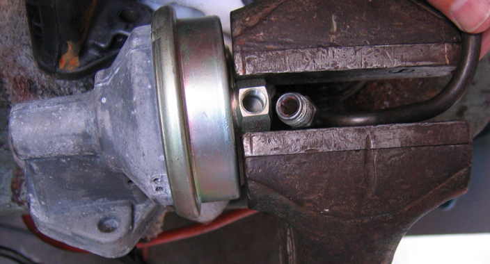

NOS AC 6972 pump is here.
Actuation force on lever: approximately 1.3 kg or 3 lbs.
Actuator travel: 2 mm
Free play in direction of actuation: 0
Side-to-side free play on shaft: 1 mm
I was aware that the angle of the fittings differ from later production, but didn’t know that the output fitting of the 6972 seems to be something like 3/8"-32? rather than the compatible 5/16" inverted-flare i (without thinking) expected:
File comment: Not going to fit

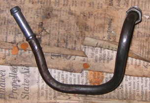

What sort of fitting(s) do i need to adapt to my installation?
Is it necessary for there to be hardline between the fuel pump and fuel filter inlet?
Is there anything special about the shape of the existing hardline, pictured below?:
