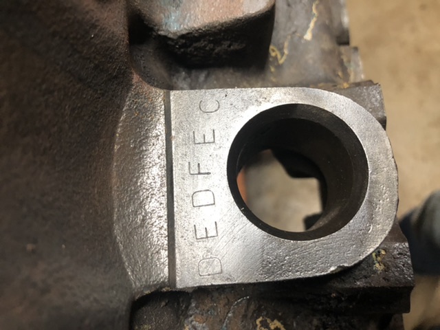

I’ve also included a picture of the distributor mount stamping. Very confused. :lol:

I think Doug will chime in with some comments.
I would say the dist markings are build stampings as they went down the crank?
Just a guess, I have seen similar on the pan rails.

A little late to this game, but. Those letters on the dist boss, are for use on the assembly line. for select fitting the pistons. The pistons are in bins with corresponding letters, and are some small amount different then the "nominal" bore size. I don't know for sure, but I think we are talking tenths of a thousand.
