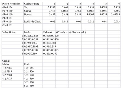

Morning Gents. I’ve worked through my measurements and was wondering how it looks to you. The rod side clearance is my only concern thus far.
I’m just starting out so let me know if I missed anything.
The pistons I have and need to replace due to major pitting, are stamped 60.
That seems to jive with the bore measurements.

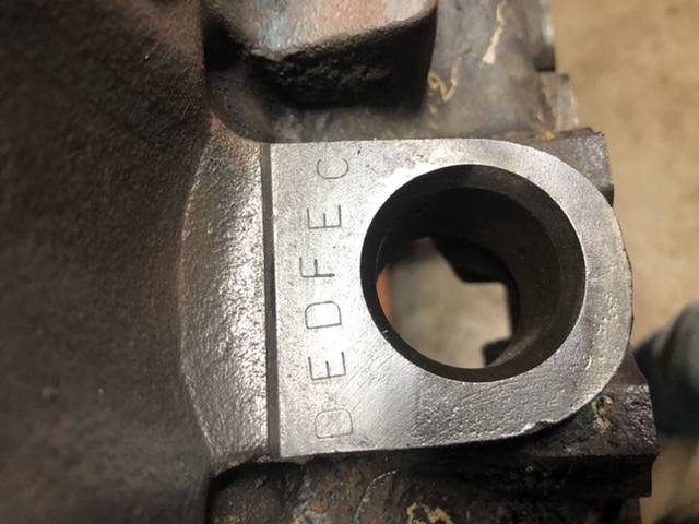

I’ve also included a picture of the distributor mount stamping. Very confused. :lol:

I would say the dist markings are build stampings as they went down the crank?
Just a guess, I have seen similar on the pan rails.

A little late to this game, but. Those letters on the dist boss, are for use on the assembly line. for select fitting the pistons. The pistons are in bins with corresponding letters, and are some small amount different then the "nominal" bore size. I don't know for sure, but I think we are talking tenths of a thousand.
