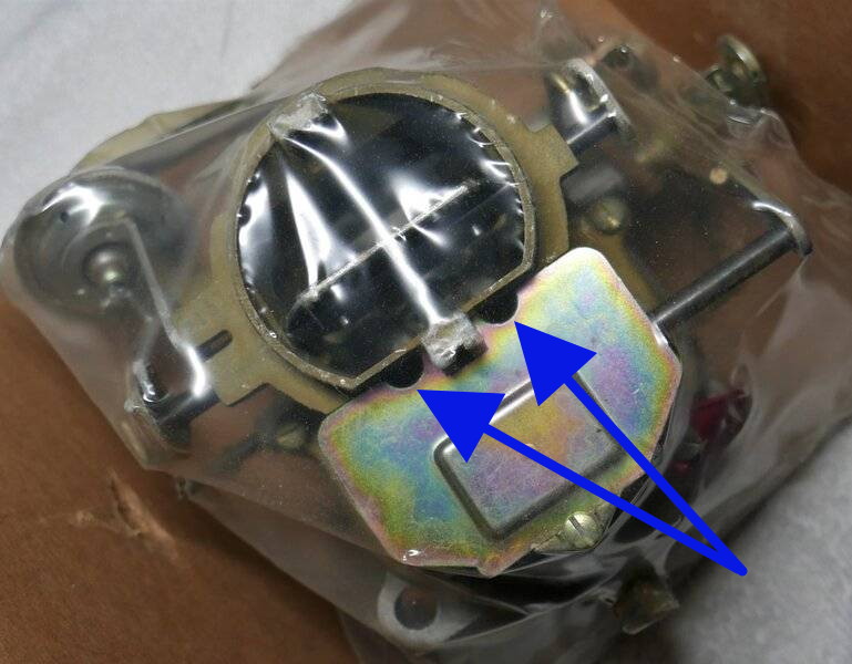

Your engine doesn't have to be overheating or running hot for percolation to occur. You do want the thick insulating base gasket, and a careful check on the float level. Make certain the carb bowl vents (indicated in the attached pic) are not blocked off by the air cleaner or its gasket.

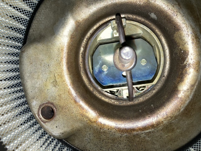

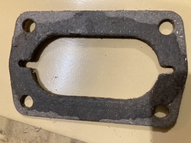

Bowl Vents do not appear blocked by the gasket or air cleaner housing.
Thin gasket I took off appears stained?

Tighten the screws accessible from the underside of the carb before you put it back on.
