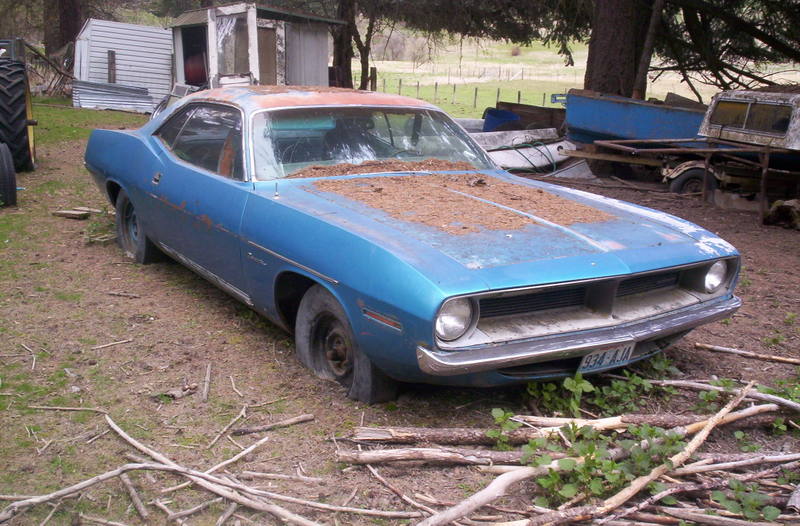

figured it's time to get this out there since I plan on going hard into getting this finished ASAP (selling my new Challenger to get 'er done, I'm done with waiting).
'70 Barracuda, 225 /6, A230 3spd, B5 Blue exterior, blue interior. This base Barracuda was made at the LA plant the 1st week of e-body production (my friend Al in So-Cal has a sister /6 Challenger made within 2 days of mine. he was in the March '91 Slant Six news. he has owned it since '73 and has put over 500K miles on it). Pretty bare bones base model. My dad bought it in '73 and drove it until @ '87 when it was parked in the back 40 .... took me 20 years to convince him I wanted to restore it for myself and not just flip it.
I've torn it completely down over the last several years and now it's about ready for paint after having several thousand$$ worth of metal repair work and going over every seam with chassis saver. paint costs have gotten absolutely ridiculous over the last several years, but I've found a solid Maaco shop that does a few classics a year (solid google rating and reviews).
For the engine my plan is to do a proper power build, but reasonable enough to be a daily driver - living in Denver I can driver 8-10months out of the year and plan on actually taking advantage of that and driving it. I've been collecting a few parts here and there, but I'm about at a stop point until I can talk to a builder so I don't buy the wrong stuff.
1970 Barracuda 225 /6, 3spd on the floor, Blue/Blue
PostPosted: Sat Jan 14, 2023 10:25 am
Posts: 9483
That will be a sweet ride! :D :D Will you go to a 4-speed? With that heavier car and a 3.91-4.30 gear in the rear, it would run sweet with the OD transmission.
PostPosted: Sat Jan 14, 2023 10:49 am
Joined: Sat Jul 13, 2013 9:17 am
Posts: 134
Location: Denver, CO
Car Model: '70 Barracuda /6 3spd
I want to do an 833 OD unit (I'm just not sure if it will work or not) and probably 3.55 gears so I can get decent highway usage to commute with it (I truly plan on driving it for 1/2 the year+). I picked up a 489 cased 8 3/4 for $300 that I'll replace the 7 1/4 unit.
PostPosted: Sat Jan 14, 2023 11:04 am
Posts: 9483
3.55 are Ok too, but 3.91 on the street with OD are fine unless you are cruising over 70mph all day.
PS. Why would the 4 speed not work? It should be almost a bolt in with the proper belhousing, shifter...etc
