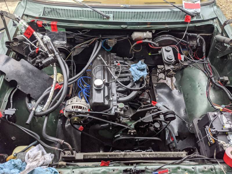

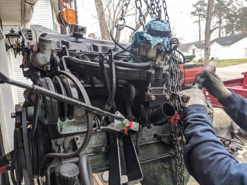

We pulled the motor over the past weekend. We found that the engine has already been bored to 060 over and it needs to be cleaned and so needs more boring or a sleeve job. Sleeves would add a significant expense - I've been trying to find if there's any danger going to 070 or 080 over on this block? Anyone have any actual experience with that? If so, where would you recommend I source those pistons, since I assume they'd need to be custom. I called Egge and checked several web sites, but anything more than 060 over isn't stocked anywhere I've found.

What year is the engine? Not sure about '80s cast crank blocks, but anything earlier than 1980 can likely go 0.100 over. Why do you think it needs to be bored? Does it have substantial ring ridges? You might just hone and put in new rings and bearings.

My block is an early 60's vintage (3 frost plug design).
It does have a ridge and so needs boring. You mentioned it could go 100 over - what piston manufacturer are you referring me to?

Right now, you may need custom pistons to go 0.080 - 0.100" over with stock 225 rods. If you use 198 rods (7" long), there are a bunch of off the shelf pistons in 0.084 - 0.105" over.
