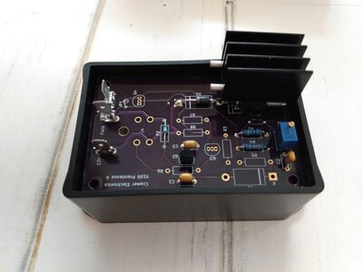

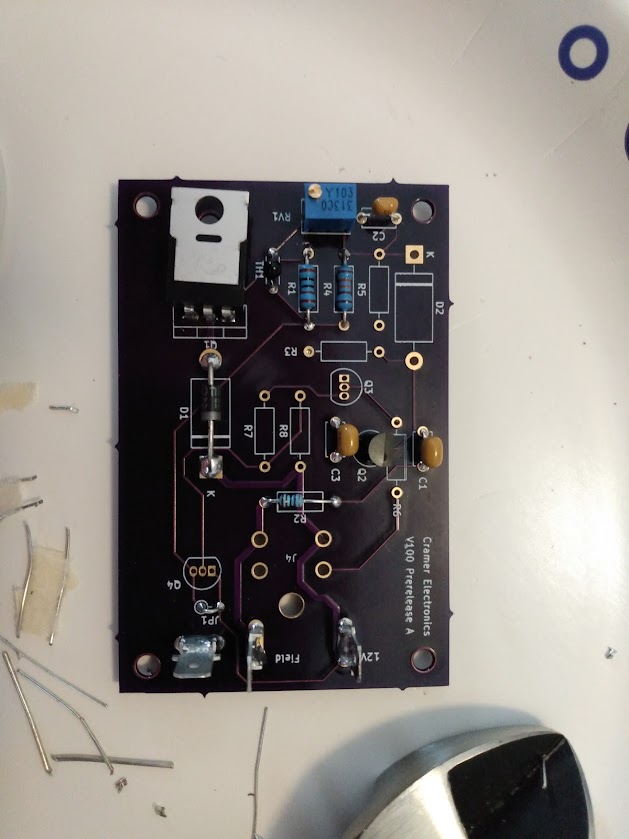

PostPosted: Sat Oct 21, 2023 11:32 am
Posts: 483
Location: Lawrenceville, GA
Car Model: 1966 Dodge Dart
The parts are trickling in. At this point I can assemble enough of one to give you an idea of what the spade terminal version will look like. Finished prototypes will be potted in clear silicone.
File comment: Partially assembled
File comment: Bare PCB
