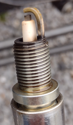

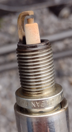

I made some adjustments today and here are the results. I've been making notes on paper and only changing one thing at a time. 1971 225 stock except for super six intake and Stromberg WW3 carb
Settings idle mixture screws 1.25 turns out this gave me the best vacuum at 19inches
Idle set at 700 car was warmed up and at operating temp
Timing 10 btdc
Accelerator pump arm on rear hole
Tried holding brake and launching at 1000rpm car wanted to stall
Car wanted to stall out when stomping gas from idle too
Did fine if I was easy on it
Change: moved accel pump to front hole
Stalling was way worse
Had to be super light.on the pedal to take off at all
So.I moved the arm back.to the rear hole.
Looking at the arm and lever I think the rear hole is less fuel and front hole is more fuel
Next change timing 5 btdc.
Still wanted to stall unless I was easy on it
Hard.to say if it was better or worse than 10 btdc
I noticed my new exhaust is blueing so I wonder if my jets are too lean or is this the right.amount of blueing. I will post a photo of that and the number 4 plug to see what y'all think. I think it's a little lean looking. White on one side and tan on the other.
 Post subject: Re: First time Racing!
PostPosted: Sat Mar 30, 2024 9:48 am
Posts: 183
Location: Southern MD
This is the same plug, number 4
