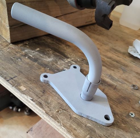

Yes they did, it looks like this:

Is there actual exhaust flowing through that? I can't imagine how that actually warms up the intake if it is just a dead end tube.. Can someone explain how the Hooker intake heat system works, for those of us who have never seen such a thing?

On the Hookers I had on my Barracuda it was just a companion flange like the one shown but on one tube.
I don't remember which but it was close to the center.
There was no hole in the header or in this plate either.
I guess the theory was as the air heated due to exhaust gasses it would rise and warm the underside of the intake.
I never used it as I had it in a race (street) engine and never ran it in cold weather.
And the Hyper Pak I had didn't have a provision for it anyway.
Interesting story,
one of the Chrysler engineers drove one of the Hyper Pak Valiants back from Daytona.
Somewhere up north the car was driving poorly.
He pulled over to find the bottom of the intake packed in a block of ice splashed up from the road.
I think they chipped it off and waited for the exhaust to melt it a little before continuing on their way.

CORRECTION: There is a hole in the bottom manifold plate! But not the header.
