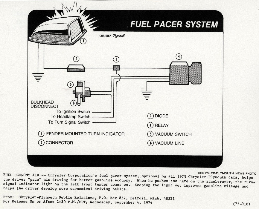

If they can't or won't clean up after their own mess and you have to wipe their butt for them, then get readin'; here are two items to get you started. There's no resistor in the system, but a diode. That makes sense, because a diode would allow the one light to do two functions, while a resistor would not. Shouldn't be hard to reckon out the specs on an off-the-shelf diode, based on a 3-watt bulb and 14-volt electrical system.
