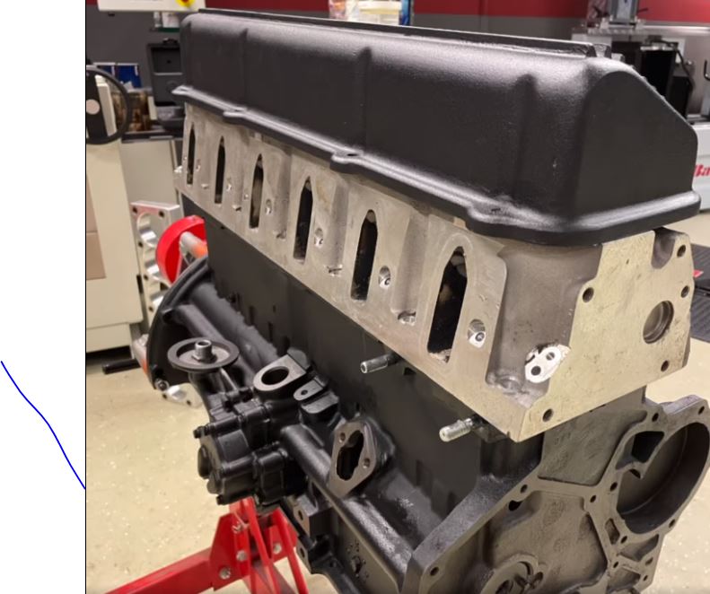

I was not sure where to put this, so Engines is where it goes.
I stumbled on this today and it was interesting to me.
EP on TV and Facebook is doing a slant build.
They have posted quite a few pictures of the build on FB.
They have an AussieSpeed intake modified by Gill Welding for FI.
They have machined a spacer for the head they are using to use the more common Valve Cover.
They are using the expensive Yellow Terra roller rockers.
They machined spacers to use a forged crank in the cast block.
They created an adapter to center the Holley mag trigger wheel on a damper.
Anyway a lot of slant based work being done.

Did Gill welding make the machined spacers to bolt an LS head onto a Slant?

The LS head is phony. It was an April Fools joke.

I'll be interested to see if they get much out of it. It mostly depends on their head porting person, and if they know anything about cam specs and where to degree it for a 225. So far, about the only magazine/enginebuilder/hotshot Slant buildup worth a $hit was when Steve Magnante teamed up with Doug Dutra in the late 90s. Rich Nedbal at Mopar Engines West (right?) also did a stout Slant for Romeo Furio in the early 2000s that was big bucks but very good. Not really a magazine buildup, although the car was in a mag or two and Romeo fed in some . That engine is still performing well in Brian Droschak's Dart (formerly Romeo's). Nothing else I can recall has done anything substantial before or since, which is annoying. If they would take 10 minutes and just ask for help/advice, their buildups would turn out a lot better. I'm always prepared to be surprised and impressed!
Yeah, the LS head gave me pause, so thanks for the April Fools exposay, ProCycle!

I read they were sticking with stock valve sizes...
Seems like a lot of trouble and expense to build a performance motor yet skip this well proven mod.
And also modified the 'cast crank' block to fit a forged crank. Seems like questionable decisions with no real advantage to doing it that way.

It looks as though they did piles of custom work that has to cost a lot of $$$ and yet skimped on a set of oversized valves that would only add a couple hundred bucks to the job and produce the best bang for their buck.

I have to ask, why in the hell would you go through the expense of machining spacers to put a forged crank in a cast block? That seems like you're just creating more chances for problems. It's not like the world has run out of forged blocks.
