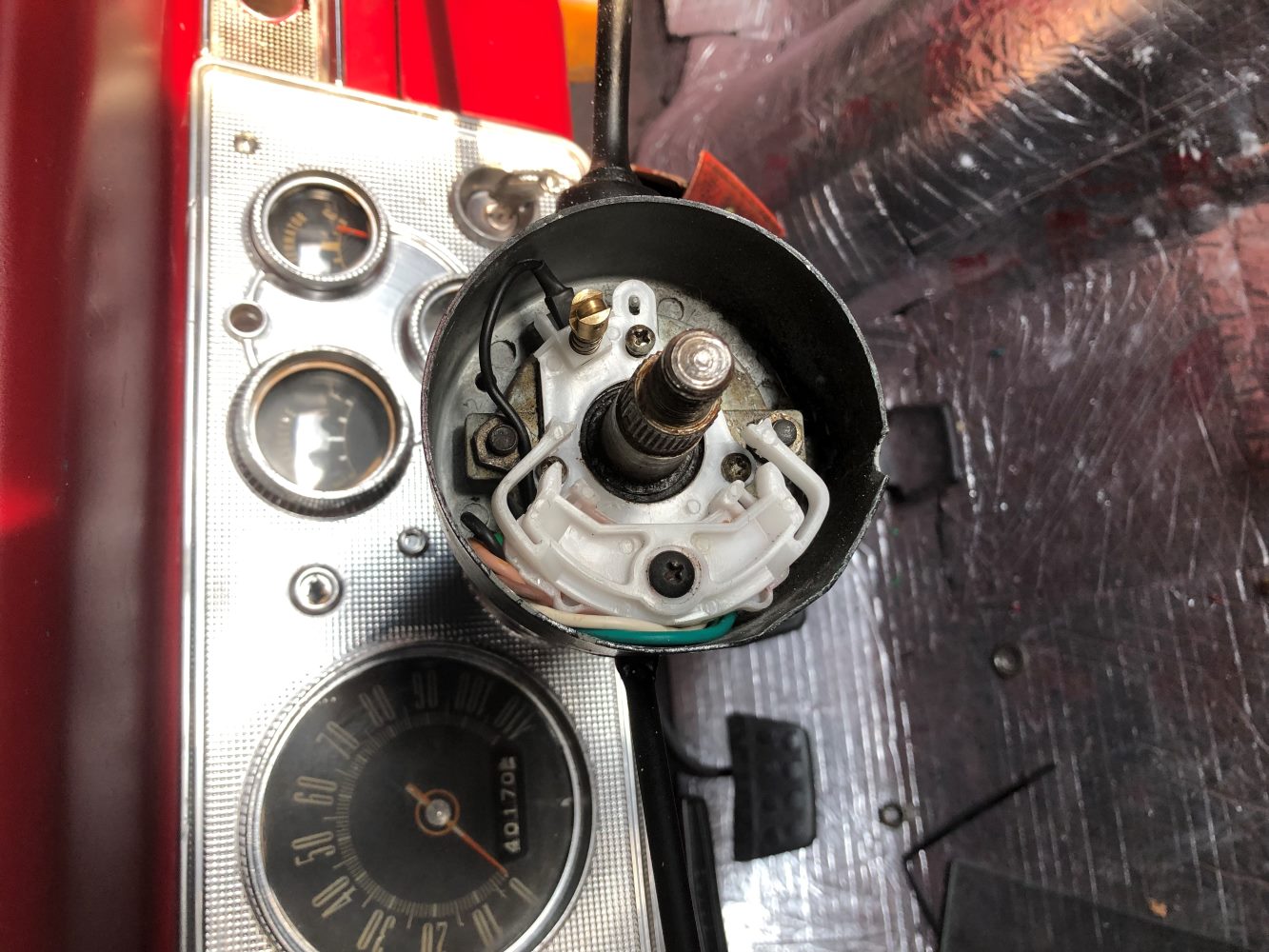

This is a pic of my installed switch.... is this thing supposed to move around or stay stationary, when using the turn signal stalk?? I'm confused as to how this switch is supposed to work...
PostPosted: Mon Jul 24, 2023 1:24 pm
Posts: 246
The outer plate is only supposed to move slightly. as the arm that attaches to it is about 12 inches long. So, help us understand what isn't working correctly.

Outer plate? No sure what you are referring to. Turn signal levers have three positions, correct? down (left) up (right) and center (off); I have the turn signal lever connected to the switch... but moving the lever with this switch doesn't have any defined positions, it just moves around. Maybe I have it installed wrong,...altough I installed it just the way the old switch was positioned/wired.
All those wires under the switch DO make installation more difficult, since they have to be compressed (smashed) in order to get all three screws seated/tightened.
PostPosted: Tue Jul 25, 2023 6:06 am
Posts: 17676
The wires should really slide down the column casing and not get too bunched up. I wonder if the long screw holding the signal lever is not engaged far enough, or the raised "block" on the lever where it hits the screw is not splining in with the switch on the bottom. The wires could be holding up the lever from getting seated into the switch from the bottom. I suggest pulling the switch off and making sure you can put the lever onto it (outside the column) and actuate the switch to the 3 positions, then pull the lever and reinstall the switch with wires out of the way.
You can also test the switch (out of the column) with the wires connected and lever attached to see if it runs the lights properly in all 3 positions.
PostPosted: Tue Jul 25, 2023 9:48 am
Posts: 142
Well, it WAS the wires ; they were preventing the switch/attaching screw to fully seat in the stalk...Moved them around a little and got it to seat. It now works. Thank you.
