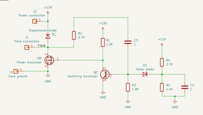

My copy of KiCad is being stubborn today, so we'll need to make due with a hand drawn schematic.
This is a very simple circuit, using a large power transistor and a smaller transistor to switch the larger one. The switching transistor is controlled by a Zener diode, Z1 on the circuit. When the voltage rises high enough, it flows through the zener diode and turns on the smaller transistor, which switches the large one off. When the voltage is low enough, current through Z1 shuts off, the large transistor switches on, and grounds the field coil. There is a capcitive coupling between the output of the power transistor and the switching transistor that limits the maximum switching speed. The reason for this is that switching off the power transistor creates a large voltage spike, which the D1 diode dumps back into the supply voltage. If the switching is too rapid, this will send too much current through D1 and can burn out D1, or even the 12 volt feed wire.
This is a rather simple circuit and rather similar to Chrysler's original design. One conspicuously absent feature is any sort of temperature compensation; batteries often need more charging voltage at lower temperatures.

I was able to draw up a better view of the existing schematic. (Note - I forgot the capacitor between pins 2 and 3 of Q2, will need to add that.)
One way you could get more accurate voltage with a factory-type regulator would be if you used the field coil wire to trigger a relay to power the regulator from the battery. If I created a regulator with a few more pins, though, it could handle the switching internally with a couple extra transistors. It may indeed be a crutch... but there's a lot of voltage drops through 40 year old wiring, and adding a few extra parts can be less trouble than chasing all them down.
Wouldn't a similar purpose be served more easily by doing as Chrysler did on their heavy-duty charging systems, bringing the alternator and regulator electrically closer by using a field-loads relay? Really easy. Get a good-quality, name-brand relay. Find the wire that presently feeds line voltage to the voltage regulator when you turn on the key. Cut it. If you've got the '70-up system, cut it upstream of the splice that also sends line voltage directly to one of the alternator's field terminals when the key is on. Upstream end goes to terminal #86 of a relay. The regulator/field end goes to terminal #87. The #85 terminal gets grounded. The #30 terminal goes to battery + (via an appropriate fuse of about 5A to 10A, depending on alternator spec). This way, turning on the ignition shows the regulator the actual battery voltage, not line voltage after dropping through the notoriously high-resistance ignition switch and master wiring weld under the dash (plus firewall connector, etc).

Dan - yes, that's a more detailed write up of what I was suggesting with the relay. If developing a regulator that uses a different plug and wiring, it would also be possible to do this internally with MOSFETs instead of a relay.

YES! I was hoping someone would do this. Hoping I see the diagram correctly would you assume that one could be made to be easily repairable? I know it may seem frivolous to do so but my curiosity gets the better of me. As a side note I have re-wired my slant as Dan recommended with running relays and such and it works flawless. My voltmeter (not ammeter) is as steady as a young man.
It's possible to build an easily repaired regulator, particularly if you used a through hole PCB. It would drive the cost up significantly since the cost of a sealed case is a lot more than simply using an open case and filling it with potting compound.
I've sometimes wondered if the sand fill was an effort to make this style of regulator repairable, but I don't think it is worth the possible manufacturing and reliability issues.

I built something like this. By varying the quantity of diodes with the reference zener could cause more or less temperature coeffient to output voltage.
However the positive side drive to the alternator field has plenty of sensitivity to wiring harness condition. This is because the regulator will pass 2-3A to the field and this will cause several hundreds of millivolts change to the voltage the regulator uses for its operation.
So it is better to convert the alternator with 2 wire field which makes possible to drive the field to the ground.
