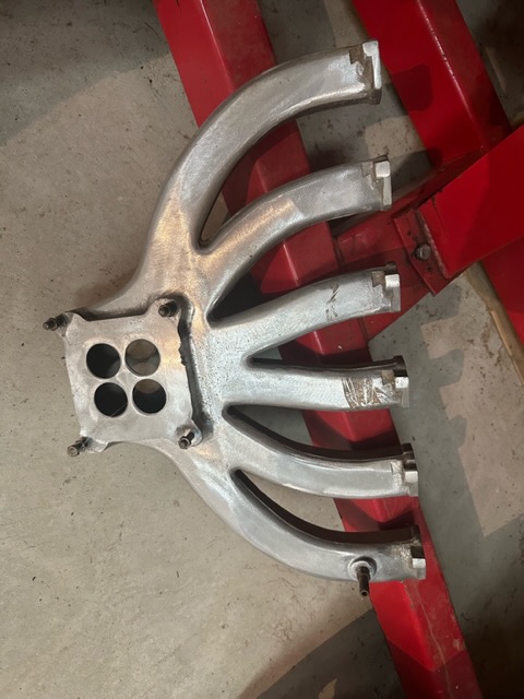

The family of the original owner of my Valiant has some parts that were never put on the car. In the lot is an intake and I have no idea what it is. I only have a picture of the top side.

Doesn't look like a Slant intake, Chevy or AMC maybe?
PostPosted: Thu Aug 10, 2023 8:52 am
Posts: 9094
Definitely not a slant six intake. A slant manifold would have the #3 and #4 runners right next to each other.
PostPosted: Thu Aug 10, 2023 9:43 am
Posts: 17689
Jeep/AMC?
PostPosted: Thu Aug 10, 2023 11:25 am
Posts: 9094
Slantsixdan called it as an Aussie "Hemi" six over on FABO. I agree.
PostPosted: Thu Aug 10, 2023 2:19 pm
Specifically, I said "Looks to me like a 1:1 match for this intake for the VG-VH ('70 through early '73) Australian Valiant Pacer 245 Hemi-6 cars."
