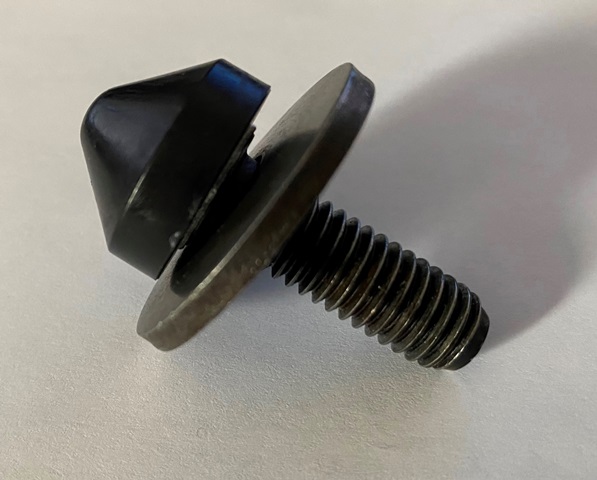

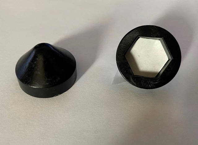

Well, just an FYI. I have these in the development stage.
Cone shaped ‘button’ that fits over a 7/16” hex bolt head (5/8” wrench)
It is Derlin, roughly 0.644" total height leaving it about 0.400" above the cam bolt head (the cone part).
It fits snugly over a factory slant six cam bolt (pictured). I put a piece of paper inside the bottom just to give contrast for the picture.
