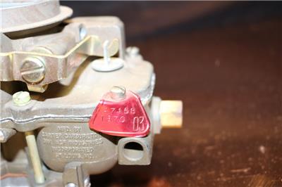

I cannot seem to upload pictures of the carburetor it has one Venturi and two bolts and it says Carter. If I can figure out how to upload pictures to the site I will send pictures of the carburetor

PostPosted: Tue Nov 14, 2023 1:42 pm
Posts: 1603
[img]
[/img] looks some thing like this?
