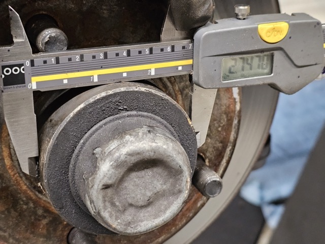

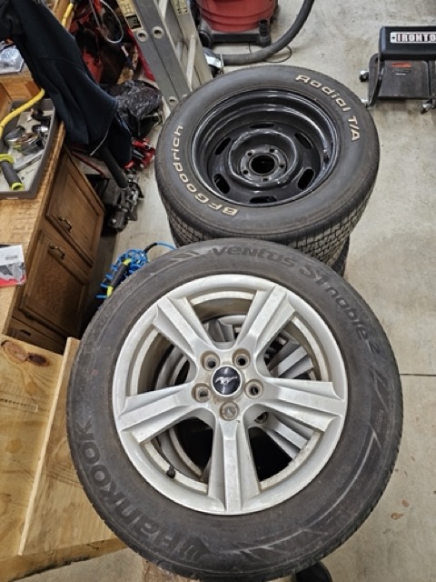

I know some of you have done this before - I wanted to create a thread to compare notes a little bit.
I'm working on modernizing a '63 valiant, and want to upgrade to 17" wheels. Tire selection for 15's just isn't very compelling anymore.
I got a set of 2019 Mustang rims for a good price recently, and am trying to figure out how to make them fit. I know some of y'all here have bored out the center hubs to fit the mopar hubs. I'm thinking. can make them fit without doing that and am curious if anyone else has done so.
I measure the hubs on the Mustang wheels at ~2.76". The mopar hub I measure at ~2.81. However, due to the offset of these wheels, they're naturally not even close to sitting on the stock flanges. Measuring the disk brake hubs on the front, they're ~2.74" past the Mopar hub diameter at the base.
The cop car rims I have measure about a 9mm positive offset, and these mustang wheels have a 37.5mm positive offset. This gives about a 1.1 inch spacer to achieve mopar factory offset with the mustang wheels.
My thought is that I can machine spacers in the back that have a Mopar hub on the inside, and a Ford hub on the outside. Then do the same for a set of spacers on the front. I'll also need to swap out the wheel lugs to be an inch or so longer. By doing this, I can preserve the factory offset (and scrub radius) for the front, keep a factory Mopar spare in the trunk in case of a flat tire, and avoid modifying the Mustang rims in the event that I want to change them for something else in the future.
Do y'all see any significant flaws with this idea?

I never machined my oe Mopar Hubs - I have always just opened up the Ford wheels.
I say you have 2 options: - use chunky bolt-on spacers to get the wheel and offset placed correctly for your needs.
With those 17'x 8's you probably need a 1.5" spacer to get upper ball joint and tie rod clearance.
Like this:
or use 3" long studs on OE MoPar Rotors and stack spacers as needed.
like this:
Sorry, these pictures are not very good..
Either way, they should work fine.

Thanks Greg! That's exactly the information I was looking for.
I'm considering the second option you posted - swap out to 3" lugs, and use a really thick spacer. I have a lathe with a 12" swing, so I was essentially figuring I could machine my own spacers that are Mopar on the inside and Ford on the outside so neither the rims nor the front rotors/rear drum hubs have to be touched.
Do you know if it matters if it's a really thick spacer vs the bolt on spacers? I've always just assumed those bolt on spacers existed so that folks didn't have to change lugs, and if you do, it doesn't matter.
Thanks for the tip about the upper ball join and tie rods. Do the tubular UCA's help with this at all? The stamping on these rims is 17x7.5J. I need to get the tires that are currently on there removed so I can do more mockups; they're way too big to fit an A Body.
Thanks again!
