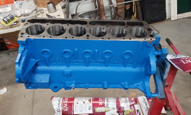

PostPosted: Mon Apr 08, 2024 9:56 am
Posts: 109
Location: Oklahoma
Car Model: 1983 Dodge D150
The switch from blue to black was around 83. My 83 was black but got painted blue recently with rustoleum spray can. Can't say how it holds up as the engine is still on the stand. Prep work is most important. Get it clean.
