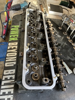

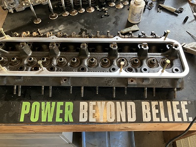

Matt (Badvert65) has had a couple valve cover spacers made up and since Ryan was in need of one, I promised Matt I would give a review of the one he sent to us. It was needed because Ryan's 260 cu in engine has roller rockers that just hit the underside of the valve cover even with 2 gaskets on it.

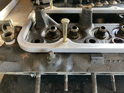

I will just say this up front. This piece looks beautiful. It is almost too nice to be under a valve cover! It is aluminum and is 3/8" thick and with 2 gaskets should gain you about a half inch of clearance.The fit of this was almost perfect on my cylinder head. Just enough room in the holes for all the bolts to easily line up.

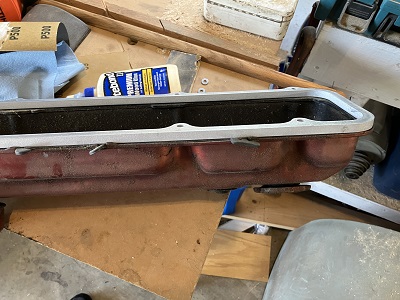

Plenty of coverage for the gasket to sit on. And the fit was perfect into the existing tabs on the old valve cover that I tested it against. All in all it was a super nice piece and I wouldn't change anything on it.
Thanks Matt for a job well done!
Here are the pictures. I will let Matt tell you how much they are and where to get one.
