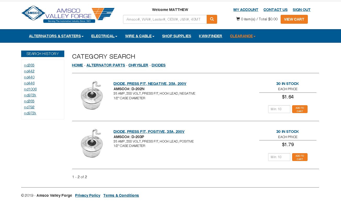

You can also get them from Amsco Valley Forge.

Now, how many and which ones are negative and/or positive?
PostPosted: Fri Jun 14, 2024 4:27 pm
Posts: 1479
The negative ones are put right into the case directly.
jus sayin....
