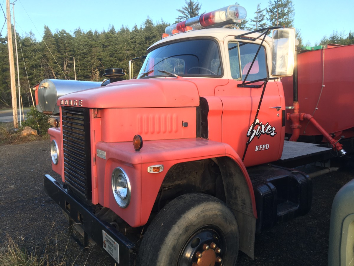

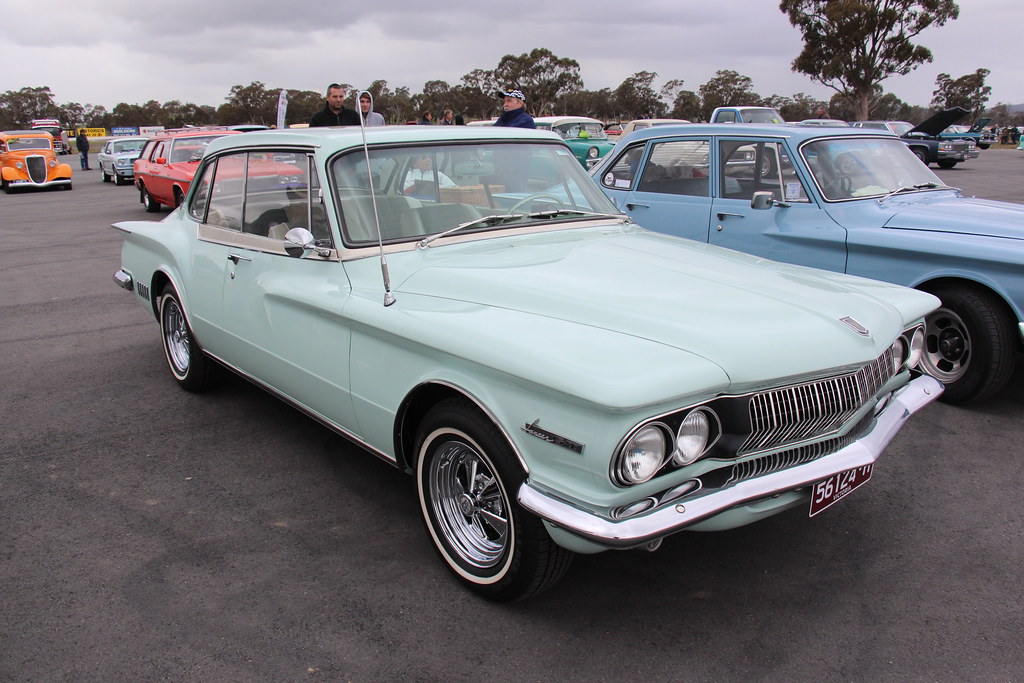

PostPosted: Fri Jul 26, 2024 1:59 pm
Okeh, now we're back to firing on all six (thanks, @Chuck !):
No, they're not even a little bit the same. Compare them side-by-each; lookit the upper corners. Lookit the lower corners. Lookit the A-pillar angle. Lookit the part of the glass outboard of an imaginary line from the upper to lower start of the wraparound; on the truck there's a triangle of glass, on the Valiant-Lancer car there's a narrow strip. Lookit the top curvature; lookit the bottom curvature.
