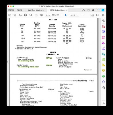

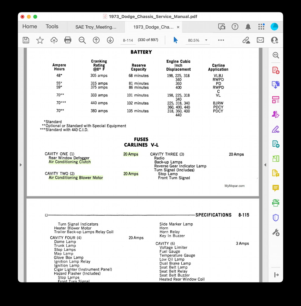

That sounds high to me—in '73 the factory put the compressor clutch and blower on separate circuits, each with a 20A fuse. An improvement in how blower current is handled also falls, for me, under "not strictly necessary but a good idea while you're at it".

Huh. Wonder why they would put a 20A fuse on a circuit carrying 30 amps. Must've been the new math! :mrgreen:

"and personal experience for the blower circuit." Possibly aftermarket replacement parts used. Just changing the blower wheel could cause additional load. Just stating I would be more concerned about the draw on the blower circuit, than on the clutch circuit. I personally have never had to repair/replace components in the clutch circuit except for the clutch itself. I have had to replace blower motors, resistors, speed switches, and push button switches, along with overheated connectors/wires in the blower circuit.
