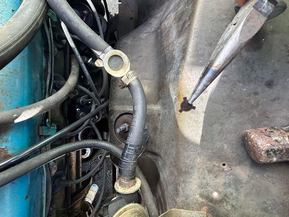

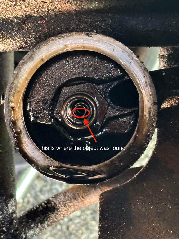

But I noticed something really weird. In the nipple that the oil filter screws, there appeared to be a piece of debris sitting on top of a spring. I thought maybe this was the source of my problem. I picked up the piece of debris, and it looked like a mechanical part. What is this thing? Do I need to put in a new oil pump? Can I do so with the engine in the car? Can I remove that spring? See photos...
Thanks!

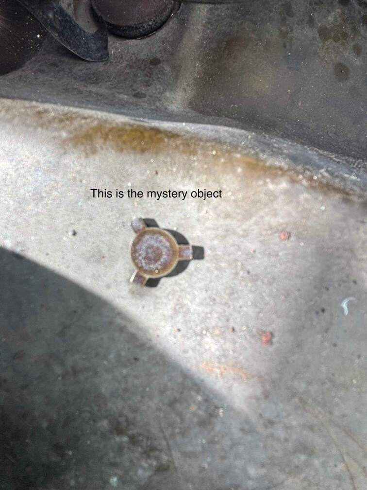

Heres the mystery object

Another view of the object

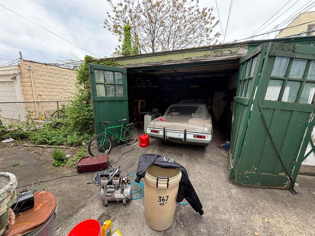

The car as I found it. I replaced the fuel tank and all fuel lines before getting it running.

That's not part of the oil filter, no; it's the valve plate from the check valve in the oil filter adapter screwed into the middle of the oil filter mount pad part of the oil pump. That check valve's nominal job is to prevent oil leaking down out of the filter after engine shutdown. The spring you see in the adapter used to hold the plate against the rim at the "ceiling" of the adapter, but it has come apart. There used to be a steel standpipe about 3 inches long pressed into that adapter; it appears to have gone missing sometime in the last 53 years, and with that gone, the valve components had enough more wiggle room to escape.
Replacement standpipe/valve assemblies are no longer available; new oil pumps come with just a plain, hollow adapter.
Remove the spring and discard it and that escaped plate, leaving you with a hollow adapter. The valve and standpipe's function can be duplicated by using a filter with an inbuilt standpipe, that is Fleetgard LF701 (best available filter of this type), or Wix 51806.
As to the problem you're experiencing: don't panic just yet. Service the oil pressure relief valve to make sure it's doing its job and isn't stuck partway open, as described in these two threads: thread 1, thread 2.
Oil pressure sending unit is 3/8" Dryseal thread. The sender is another likely cause of this oil light behaviour; it might go away just by replacing the sender (but you should still service the relief valve).
Alternate location to put in a mechanical pressure gauge: the 3/8" dryseal-threaded pipe plug on the passenger side of the block, near the rearmost extent of the oil galley.
