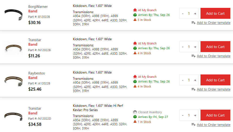

Hey, there's a Transtar branch in Houston! Which one of these kickdown bands should I use?

Frank, sorry I didn't get back to you about the band. I missed that post. As for the front pump washers, I always replace them. Usually they come in a trans kit. Even if you need to get them extra, I feel it is cheap insurance. Having to pull the trans to correct a leak is not one of my favorite jobs.

No worries, Charlie. I went ahead and got the kevlar band from Transtar, but the one I got didn't seem made very well. Once I had it installed, it looked like one of the end pieces was mounted just barely off kilter, in a way that made me worry the edge of the band would drag on the edge of the front drum. I found another 1.6" wide band in the parts bin that was much straighter and used that one instead. It seems to have plenty of side clearance.
