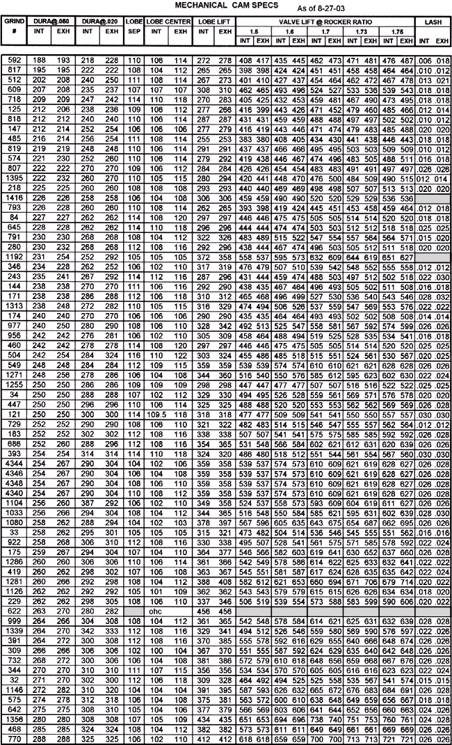

Current setup is a 72 d100, granny gear 4 speed, 3.55 gears, cast crank block, drool tube head and Super Six manifold and carb. The head has a .100" cut, chambers at 44cc, pistons are .175 below deck, doing the math I get a 9.24:1 SCR. I run 91octane, limited advance distributor and the vac pod is set really tight. Other than grinding out/ cleaning up the intake, exhaust runners, ports and chambers there is no other headwork. Unfortunately I chose the 2106 RV cam whose IVC is 31* and the cranking compression is 175psi. Doing the math again and that's an 8.3:1 DCR. The truck runs great until the revs get near 2,800 it pings and even with the timing backed off it wont rev under any load past 3K-ish. Been reading here for acceptable cams with later IVCs many of you use and have positive things to say.
The Erson 270 looks to be really popular with the medium compression crowd but I don't see an OCG grind that looks similar. Don't think I need lots of valve lift but it seems that the longer durations always come with more lift. Fortunately/ unfortunately the OCG cam chart has like 70+ grinds and there's no chance I'd be able to whittle down all of those specs into the exact cam for my truck. I have no aspirations to race, rev past 4K or have a lumpy idle, the truck doesn't tow and rarely hauls anything larger than an A motor.

Thanks for the well posed question and all the data. I’m traveling and without much time but I can work up an ocg cam for you later this week to suit you. What total mech timing advance are you running at 2800+ rpm where it is pinging?

I just realized you said 175 psi cranking compression. This means to me that you can run on 91 octane with suitable timing and fuel. I have run up to about 190 psi on CA pump premium (when I lived in LA in the late 90s thru 2002).
Since you are saying max timing advance at 24 deg with the vac disconnected, that should be safe and not ping. Try running with vac adv disco'ed just to make sure it is not hanging up or somehow still giving advance. If it is still pinging, then it is possible/likely that your damper ring has slipped and you are not actually getting 24 deg max advance but more than that. You should be able to run up to about 28-30 deg with that cranking comp value. You should also have gobs of torque across the RPM range and good HP up to at least 4500 RPM if carb is working right.
If your damper has slipped you can just replace it with a new/rebuilt one, or you can recalibrate it by getting a TDC stop and degree wheel. I would just replace it because if it has slipped then it may slip again or come apart.
Try those tests. If timing is actually correct, then you have a carb/fuel problem. The other option is that your cam timing is too far advanced, as that would explain your soft power above 2500.
Happy to discuss more. I would not do a cam swap at this point.
