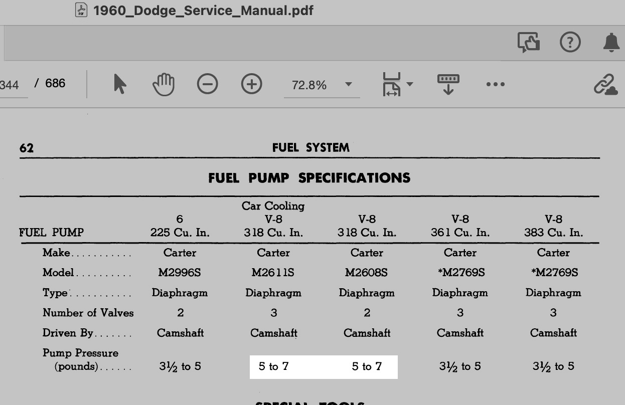

PostPosted: Mon Nov 04, 2024 9:33 am
Every factory carburetor fuel pump that I can recall seeing is spec'ed at about 4psi.
Careful, Doc. "I've only seen X, so therefore there's nothing else" is a close relative of "I've never seen it, therefore it doesn't exist". Both are faulty.

Okay. After a very cursory review of contemporary fuel pump pressure specs, it looks as though the fours and sixes (Jeep, Rambler, Dart) were spec'd at around 4psi, while the eights (Ford, Chevy, Olds) were spec'd at around 5-6psi.
So, you are correct, and I am wrong, by the letter (or number), but my general point, that 8psi is, as Brother Maynard would say, "right out," remains valid.
I shall revise my recollection of normal fuel pump pressures accordingly, and retroactively.

I'm sorry. I'll push back on this one. The same carburetors are used on many older cars with gravity-feed fuel, and later vehicles with fuel pumps (for instance, my 1959 Case bulldozer uses the same carburetor as a Model A Ford).
The low pressures of most fuel pumps on carbureted engines are not dissimilar to the pressures encountered in gravity-fed systems, and carburetors were not necessarily changed when the switch was made to fuel pumps in the 1930s (considering that V8s often required carburetors on top, usually downdraft, instead of updraft carburetors that could be placed on the sides of inline engines).
Do you know of other specific reasons why these pressures were chosen that would exclude gravity / pump interoperability as an explanation?

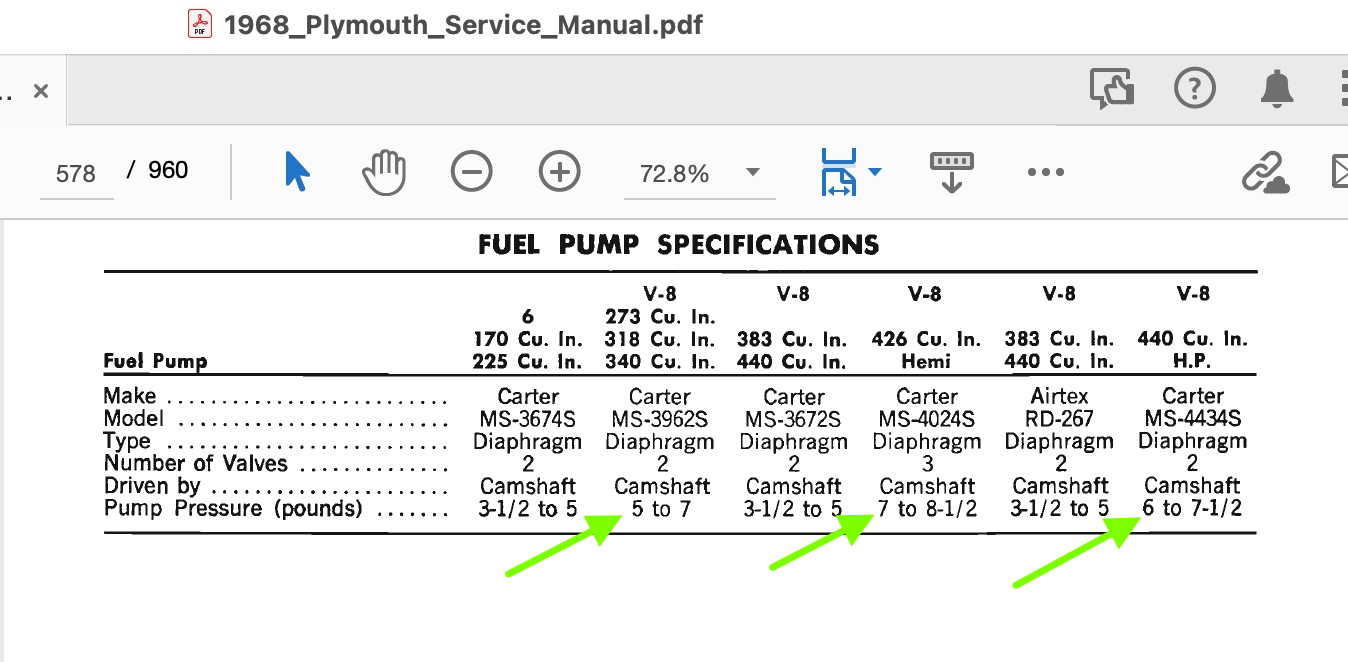

PostPosted: Mon Nov 04, 2024 5:49 pm
Take another look at the second pic I posted.
'68 426 Hemi 8.5psi and HiPo 440 7.5psi. Outliers.
II'll push back on this one.
Go ahead—when you have examples relevant to the Slant-6 or its contemporaries.
Slow evolution from a clear common origin. Pressures creep up from the initial ~3psi over several decades.
Ford Flathead V8 from the early thirties through the early fifties: 3.5 - 4.5psi.
Packard Straight-8 1950: 3.5 - 5.5psi.
You get pressures coming up another psi or two with "new technology" 1960s engines, as deigns diverge from their origins.
