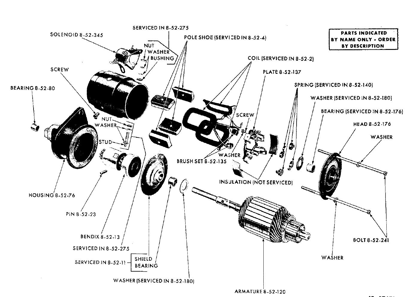

Click the links for the already-overhauled starters I pointed at above. These starters were built by Prestolite (calling themselves "Auto-Lite" at the time). Here's the FPC explod-o-view:

Donno, your pic didn't post! :mrgreen: There was a Chrysler-built direct-drive starter, some versions of which will replace the Prestolite starter. The Chrysler direct-drive starter is a solenoid-shift item, not bendix-drive like the Prestolites. That Chrysler "tin can" starter, as it was known to rebuilders because of the big round solenoid perched on the motor housing, was used on Slant-6s in trucks and heavy-duty passenger cars (taxicabs…) with the 11" clutch. I saw one in a Slant-6/automatic '71 Valiant in a wrecking yard many years ago; no idea why that car had that starter, and it looked like a factory install. The '70-'71 FPC says they were used on B- and C-body cars "heavy duty, w/manual trans", but not on any automatics, so who knows why that one I saw was in that '71 Valiant.
But I'm glad you mentioned your dad's '63 Dart, because I'm newly reminded the '63 FPC does say the Prestolite MDT-7009 direct-drive starter, that's the same as the '60-'61 starter, was installed on Slant-6s in some US-built '63 A- and B-bodies. I've never seen such a one, but maybe your dad's was. Perhaps the OP's car, too.
