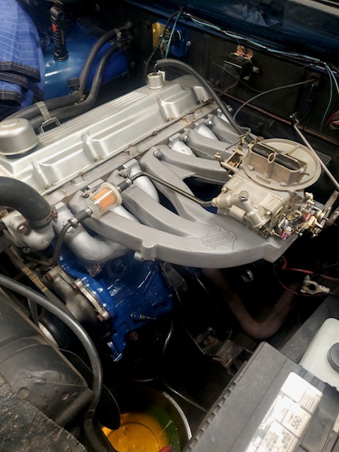

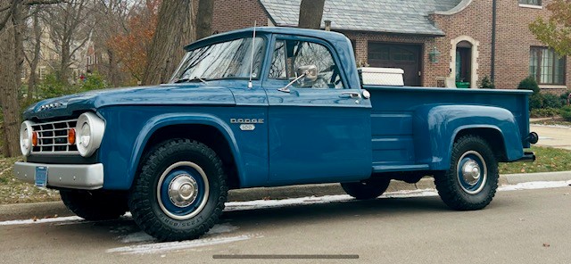

Guys, Hoping to buy a complete A833 4-Speed from a Mopar Truck (1966–1971).
I have a 1965 Dodge D100 i've made a few mods to and I I'd like to get my hands on a full set up for a direct swap. If anybody is within a few hundred miles of Milwaukee Area i'd be interested.
On another note, my transmission is current a A745 3-Speed. Anybody have experience with doing a swap on these?
I have access to a very nice 1970-1974 B&E body full transmission set up - but i believe that will require a bunch more hassle with bellhousing, linkage, shift assembly, etc.
