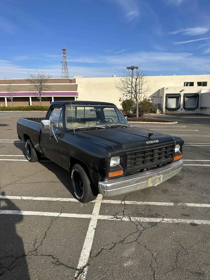

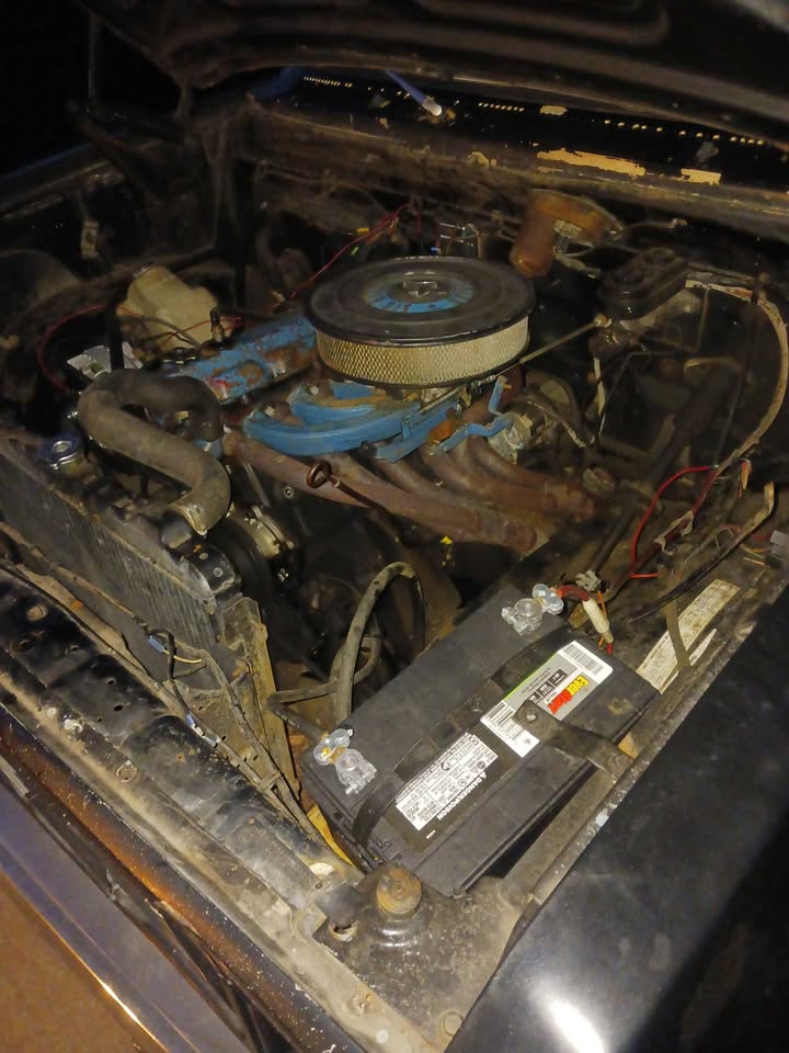

Hey all. Just got a 182 d150 short bed. Came with a nice running slant w a bid holley 2 bbl and old Aussiespeed headers on it. Hei swapped and oit looks like a newish rebuild.
The trans is a 833 4 speed and is very noisy, and irritated. I cant use 4th at all for fear of the loud angry cat inside of it getting loose and mauling me to death.
I have a 904 and a 727 that will bolt up and a cross member. is the existing drive shaft usable for the 904? I would put in a locar floor shifter and a shift kit as well so what recommendations might you have for this?

This a833 is leaking from everywhere and is screaming in all gears,,,,but 4th is an unholy nightmare of a sound.
I know my transmissions will bolt in. What I don't know is the length of the drive shafts needed for each one in a short bed truck.

Also, through the weekends diggings i found that this is a recent reman engine. This bugger is CLEAN. The long block is brand new. still has pristine brand new black engine paint on it with old valve cover, oil pan and dirty old accessories. Oil covered, caked with gack and very loosely bolted on the engine. It is a hydraulic valve train engine. Whoever put it together neglected to install a timing cover seal so that just spewed oil everywhere.....Still has the "mexico" tag on the front of the motor. Pretty excited.
