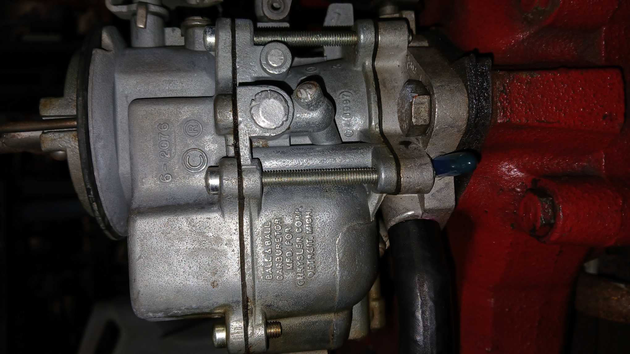

So here's the situation. I have this remanufactured BBS on my '66 225 Dart. I've put hundreds of miles on it and it seems to run pretty well other than two slight issues:
1. The exhaust always smells very rich despite any adjustments I make to the carb.
2. On hot starts, the throttle must be held wide open to start, even after short drives.

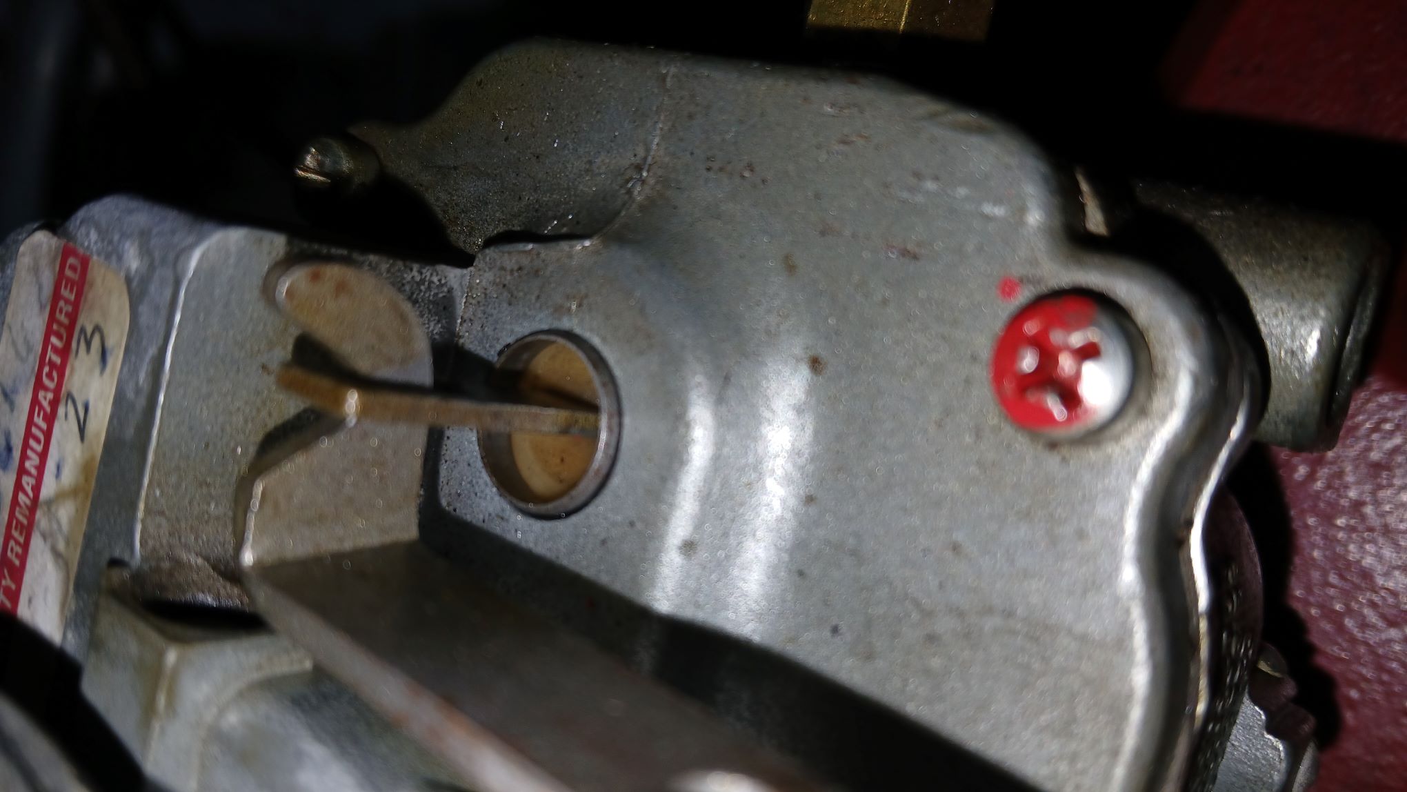

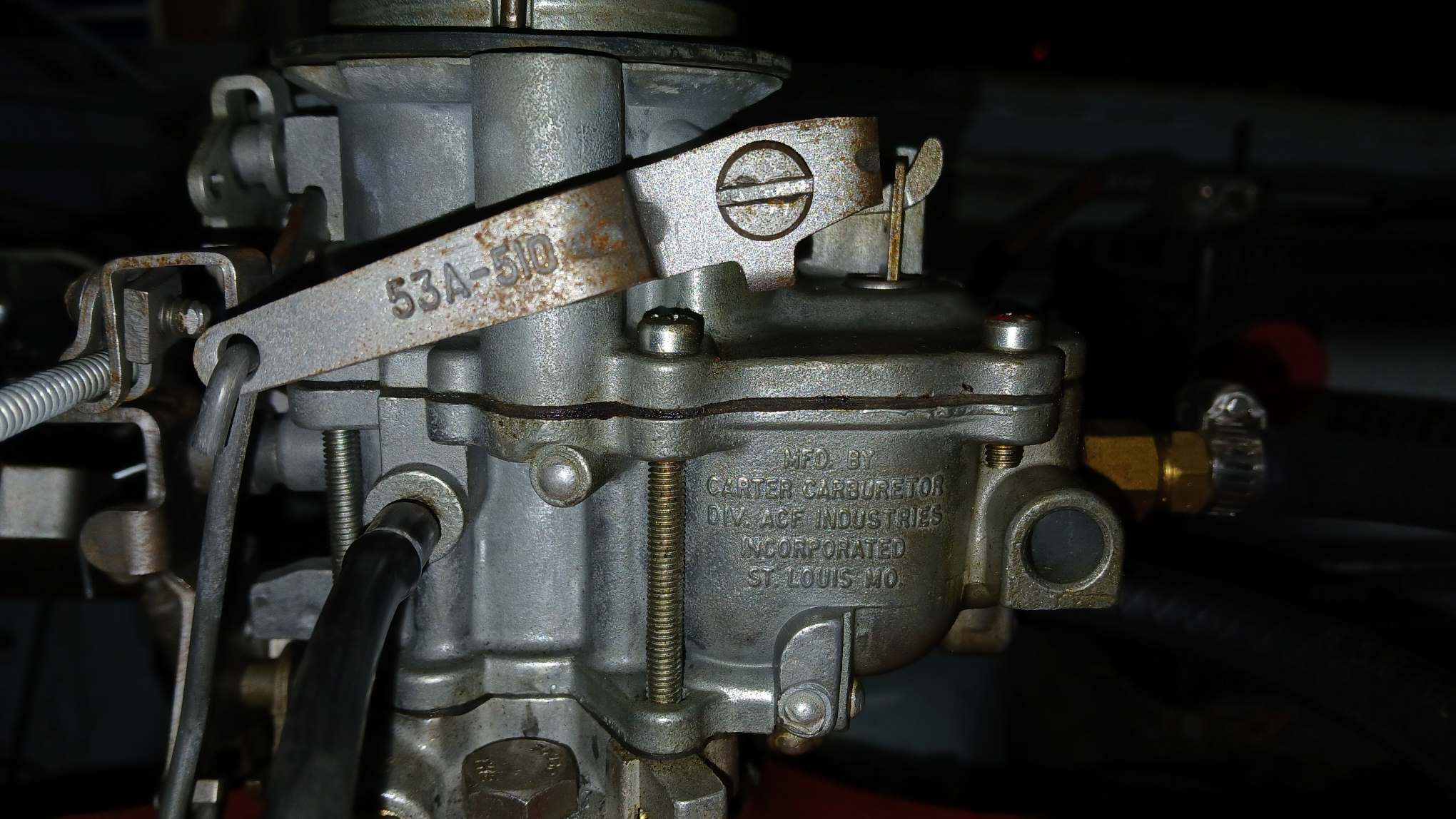

This seems to be a later BBS (I'm guessing from a '69+ truck since it has a choke cable bracket and no vacuum pulloff) I'm beginning to wonder if the bowl vent could be part of the problems. Or if it is missing parts or has just been assembled incorrectly. I've done some searching and can't seem to find another BBS with this setup. (See attachments below) They either have a "cap" that opens and closes with the accelerator pump, or a plastic vent tube on top of the bowl. So my main questions are, is this bowl vent setup correct for this era of BBS? And could an issue with this vent be attributing to my symptoms listed above? any insight would be appreciated!
Also this is my 1st post on the board, so hopefully I've done this right!

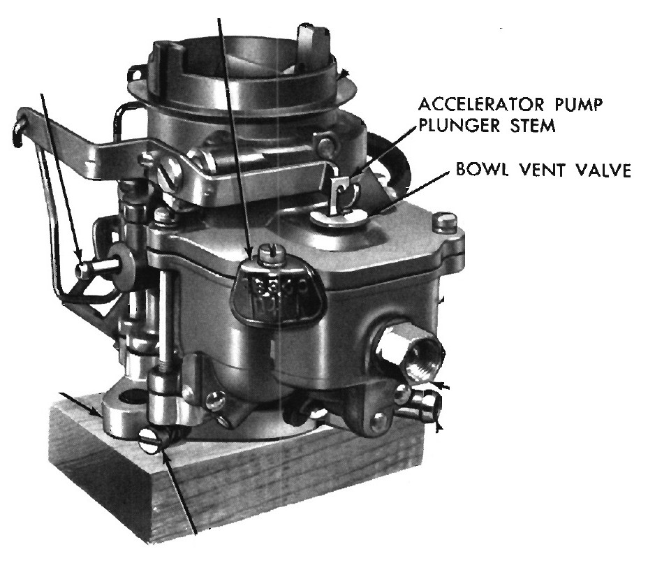

The cause of the problem—at least one of the causes—is there is no external bowl vent on your carb. There's meant to be a round metal disk atop the carburetor casting, with a slot through which the accelerator pump stem passes. There are three grooves on the stem. A hairpin clip is installed on one of the grooves—which one corresponds to which hole in the throttle lever contains the link to the accelerator pump lift lever—such that when the throttle closes and lifts up the stem, the disk is lifted up by the hairpin clip to provide the bowl's external vent.
Instead, the "remanufacturer" installed wrong parts—a plastic disk under the carburetor casting—such that there is never the intended atmospheric bowl vent at closed and near-closed throttle. This setup is appropriate only for '70-up California and '71-up 49-state/Canada BBS carburetors with a separate external bowl vent valve and a ducted bowl vent outlet, which your carb doesn't have.
The missing disk is identified here as "Bowl vent valve":

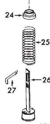

There's a little metal bushing/hat, the bowl vent valve seat/accelerator pump spring retainer, which goes at the top of the accelerator pump spring and protrudes upward through the carb casting, to give the disk (bowl vent valve) a uniform surface to seal on (it would not do so against the uneven top of the carb casting). The bushing, identified here as 24, is Walker part № 22-53; no idea if it's still available, but from your photos it looks like that part is present on your carb, so all you'd need is the disk.
