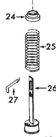

There's a little metal bushing/hat, the bowl vent valve seat/accelerator pump spring retainer, which goes at the top of the accelerator pump spring and protrudes upward through the carb casting, to give the disk (bowl vent valve) a uniform surface to seal on (it would not do so against the uneven top of the carb casting). The bushing, identified here as 24, is Walker part № 22-53; no idea if it's still available, but from your photos it looks like that part is present on your carb, so all you'd need is the disk.

There's no aftermarket coverage of the bowl vent valve disk, but it (with that seat/retainer bushing) was used on gazillions of BBS and BBD carburetors pre-'71, so you ought to be able to scare one up.
Fix this (all the way fixed; this will call for careful adjustment of the accelerator pump stroke and bowl vent opening per the service manual), double-check your float adjustment while the carb is apart (see here), and the problems should get a whole lot better. Yes, this means you'll be opening up your carburetor and will need a rebuild kit for it which contains good gaskets. Parts store kits are no damn good any more, when you can even get them. Go directly to The Carburetor Shop for a worthy kit. It'll cost more than parts store trinkets, and it'll be worth it. Since there's no longer a carb ID tag, you will have to specify a closest-guess carb (№ 4905s) to get a correct kit. Set the float to 7/32", using the correct gauge, per the procedure in the manual.
